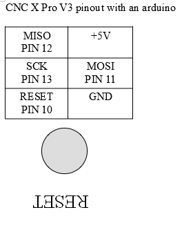

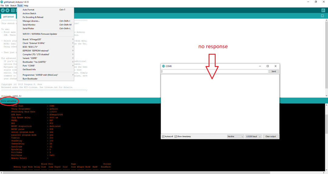

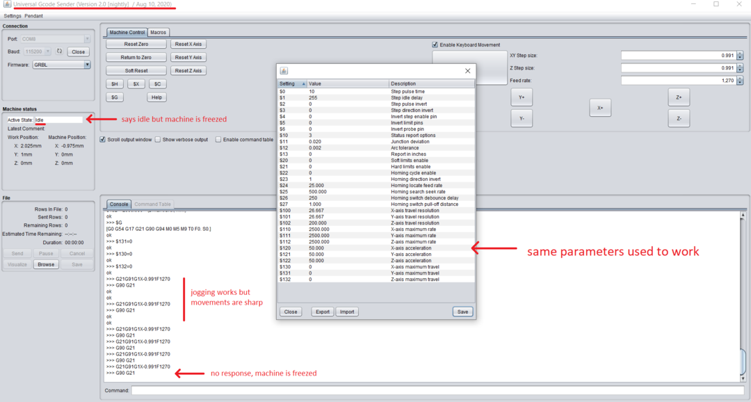

    Happy owner of a Xpro v3 for many years, I encountered an issue. Xpro is driving an ox cnc from ooznest. Jogging works in all direction but the machine freezes after some commands. We talk with Mike from Spark concept who admitted this was a curious case.
    • ox cnc jog in all directions but with sharp movements. I checked grbl parameters which are the same as when the CNC ran smoothly.
      After some commands (like pressing right arrow to jog right) the machine freeze and only rebooting the xpro makes it works again. Sending gcode makes it immediatly freeze.
    • some years ago, when Xpro was not responding, I used to reflash grbl 0.9j with Xloader. This time my attemps failed.
    • flashing grbl with arduino IDE failed : "mismatch at byte 0x0000 0x62 !=0x0c". Same with eeprom_clear as recommended by ooznest.

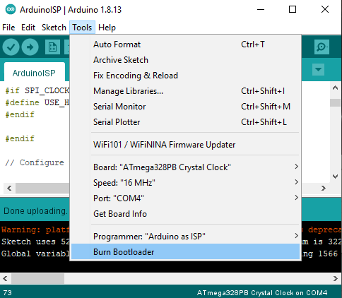

      I read from Peter Van Der Walt it is linked to the Xpro being an Atmega 328pb whose bootloader is probably corrupted.
    • with a spare arduino set as an ISP programmer, I successfully burnt the Xpro bootloader.

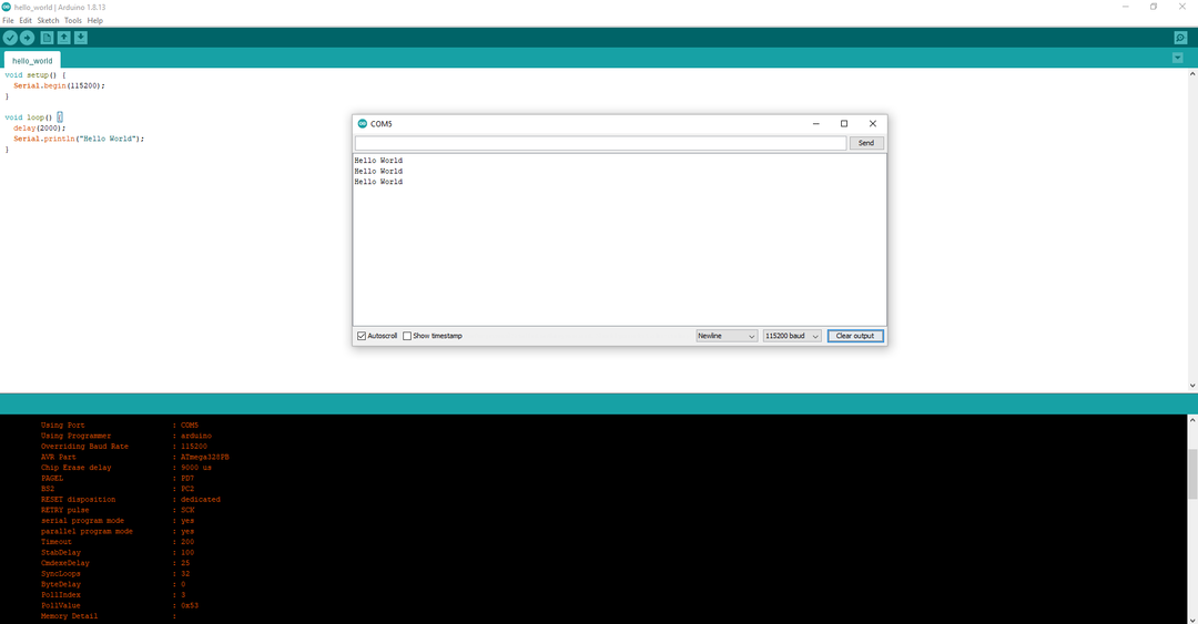

    • Then I successfully uploaded grbl 0.9j. Still the Xpro does not respond on serial monitor nor UGS (even when given "$$" or "M8" commands).
    • same grbl sketch works and responds when uploaded on my spare arduino
      FTDI drivers are up to date
      Xpro is blinking when uploaded with "blink" sketch
      Xpro is responding when uploaded with a simple "Hello World" sketch
    EDIT : Thanks to Mike from Spark Concepts and Peter Van Der Walt from OpenBuilds, I tried alternative ways for flashing grbl on my Xpro. For unknowns reasons my attemps with arduino IDE failed but things worked fine with Estlcam and OpenBuildsControl softwares. Thank you very much :thumbsup:

    Thanks to an older post of yours I find MiniCore and successfully burned the bootloader as an atmega328pb.
    It allowed me to successfully upload grbl 0.9j but still the board didn't respond on serial monitor.
    Mike from Spark Concepts suggested me to try Estlcam and it brough my CNC back to live !
    Still a mystery : same hardware and software, not responding with arduino IDE nor UGS but running strong with Estlcam o_O

    Remebered to change baud rate on connection? Newer versions of grbl uses 115200, older was 9600. Can be that you did not change selection in software?
  13. Nicolas P.
    Nov 25, 2016
    Just flashed my Xpro with OpenBuildsControl and now everything is working fine with Arduino IDE and UGS responding as they should. Big thanks Peter Van Der Walt !
    In conclusion something gone wrong with how I flashed Grbl with arduino IDE but I don't know what (both tried 115200 and 9600 baud rates).
