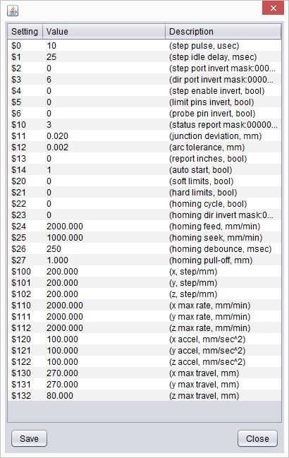

    Hi Ryan
    Thanks for your reply
    no $4 is set to $0, I have all settings as per the photo supplied with the c-beam kit. C-Beam Machine GRBL Settings.JPG
  2. Ryan Lock
    Ryan Lock Veteran
    Oct 12, 2014
    530
    286
    That could be the cause, on the new xPros $4 should be 1

    Hi -
    Thanks for pointing this out @ryan! I just finished my OX tonight and I really fretted over why I could not get the motors to turn, whatever I was trying. I have undo/redo all my wiring, checked again and again while it was just a setting!
    Well, that should probably be fixed in OX build instructions in order other guys not to face the same problem.

    Ahah I just found a folded sheet of paper in one of the box. Guess what? It is titled "Manual Amendment" and it gives instructions regarding the settings which are a bit different in the latest batch of CNC xPro. ;)
    Ryan: maybe you should insert it in the printed manual in order for the makers not to discover it after the kit is built and CNC is working! LOL :)
