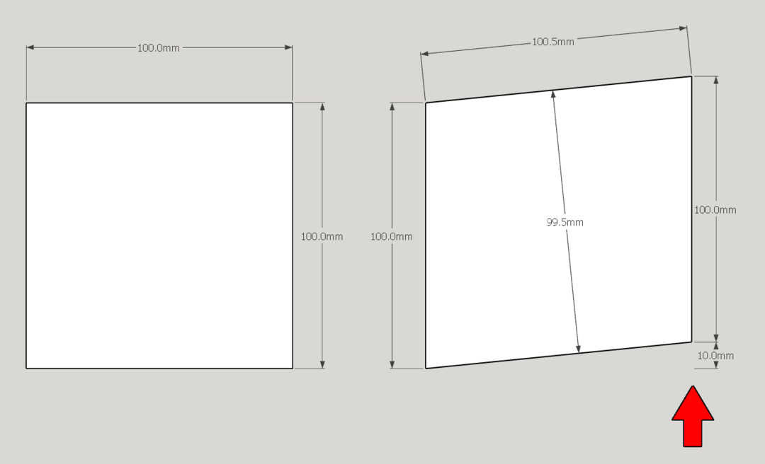

    On my home cnc i just did a handfull of project mostly decorative stuff,so most of the time the precision was not really necessary.I also just noticed something when i did the pocketing toolpath with my 6m endmill when the endmill goes from the right direction there was no chattering.But when the endmil travels the left side there was a noticebla chatter.Than i incrased the rpm durring the work from 13000rpm to 2000.The chattering was off both sides.It was like 15 or 20mm/s feed.So i just wonder whats the case with this because i saw a lot of folks on yt using a workbee cnc milling with lower rpm (10000-13000rpm) with no problem?!And yeah i dont remember their feed or doc,so maybe thats the case with this.So i noticed maybe the high rpm and diferent endmill will do the job with no to minimum cuting size error.Also i have to check if the machine is square.Can that cause the errors in my cuts?I hope i will found the solution after all.And thanks EVERYONE for the tips!
  21. Peter Van Der Walt
    14,701
    4,249
    Tramming can effect squareness, which can affect measurements. See Tramming: A generic guideline
    For example, X and Y not square to each other
    Also check for unwanted play / looseness in your machine, the chattering combined with dimensional issues could indicate something moving that shouldn't. Grip the endmill, give it a wiggle, if you feel movement, follow the feeling of the play to find the source.

    This is really helpful!Thanks.First thing i did today is that make sure that my table is flat as it could be.It was WAY off.Noticed that when i did the spoilboard surfaceing.Tomorrow i will make sure that the machine is square and so on.
    I didnt checked these things when i was buildin the machine,cause iam a beginner in this area.But this is a great place to learn from others.So again,thanks people!
  23. Alex Chambers
    2,760
    1,352
    As well as checking the diagonals of the frame to check for square, and checking that your X axis is square to the Y axis, tape some thin thread across the diagonals of the frame - they should JUST touch each other in the centre. If they don't touch, or one pushes the other out of line the frame is twisted and you need to adjust it by putting shims under the lowest corner.
