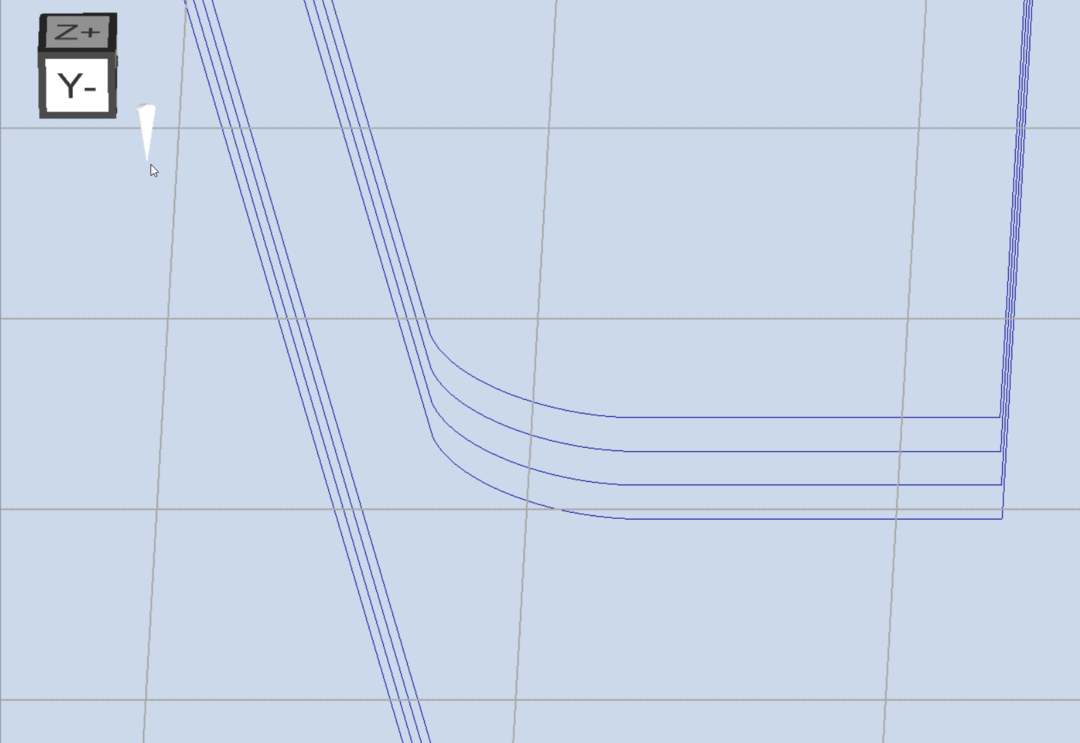

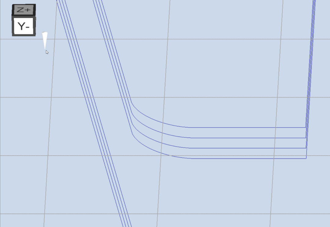

    Also if you stop defining curves as bezier Vcarve should output the G-code for arcs. (you are using the correct post processor)

    I haven’t noticed a difference in the cut quality between the two so I’ll stick to the circular arcs in vcarve. Glad I’m using the correct p/p.

    i tossed the G-code you posted into UGS and it looks like nice smooth curves to me.
    Post your $$ settings from your xPro. This is belted? 20tooth? did you dual belt ?

    I’m glad is smooth on your end that confirms it’s a machine issue or setting issue.

    Hi Phoenix, your speeds and accelerations are a bit aggressive and can lead to the step-loss and chatter, try 5000mm/min max speed and 500mm/s^2 acceleration (1500mm/min should be fine on Z)
