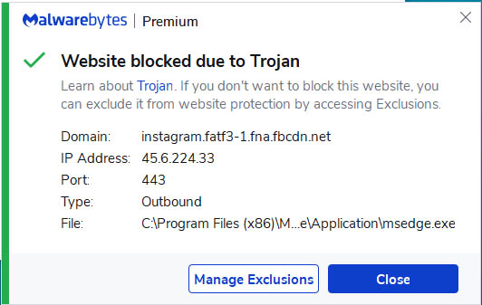

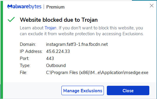

    I have been getting this message everytime I click on your site for the last few days from Malwarebytes 4.4.6. This is while using MS edge or firefox browser.
  7. Peter Van Der Walt
    14,038
    4,122
    Malware bytes is becoming like AVG did a couple years ago - extortionist. The URL is part of facebook/instagram (fbcdn.com = facebook content delivery network) - I don't use Malwarebytes anymore, it fearmongers in the hope of getting your subscription fees (;

    O
    Ok, I will ignore it then.
