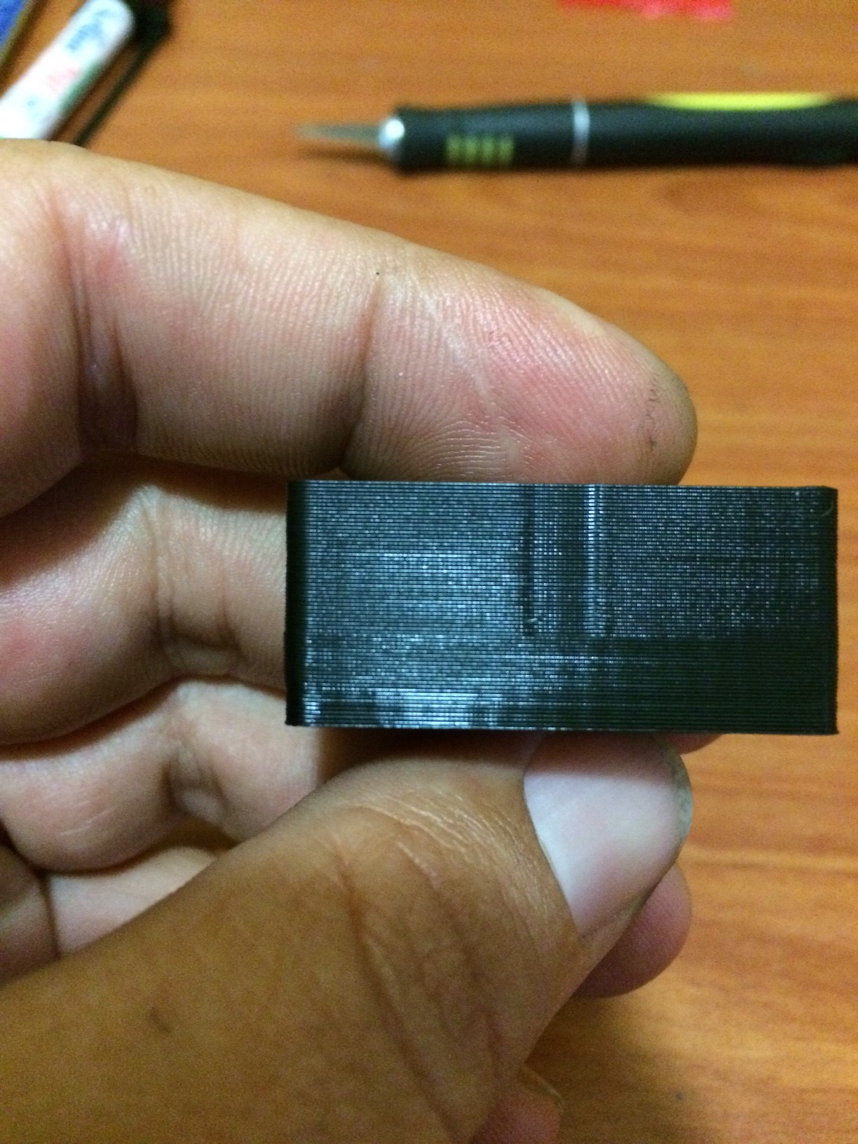

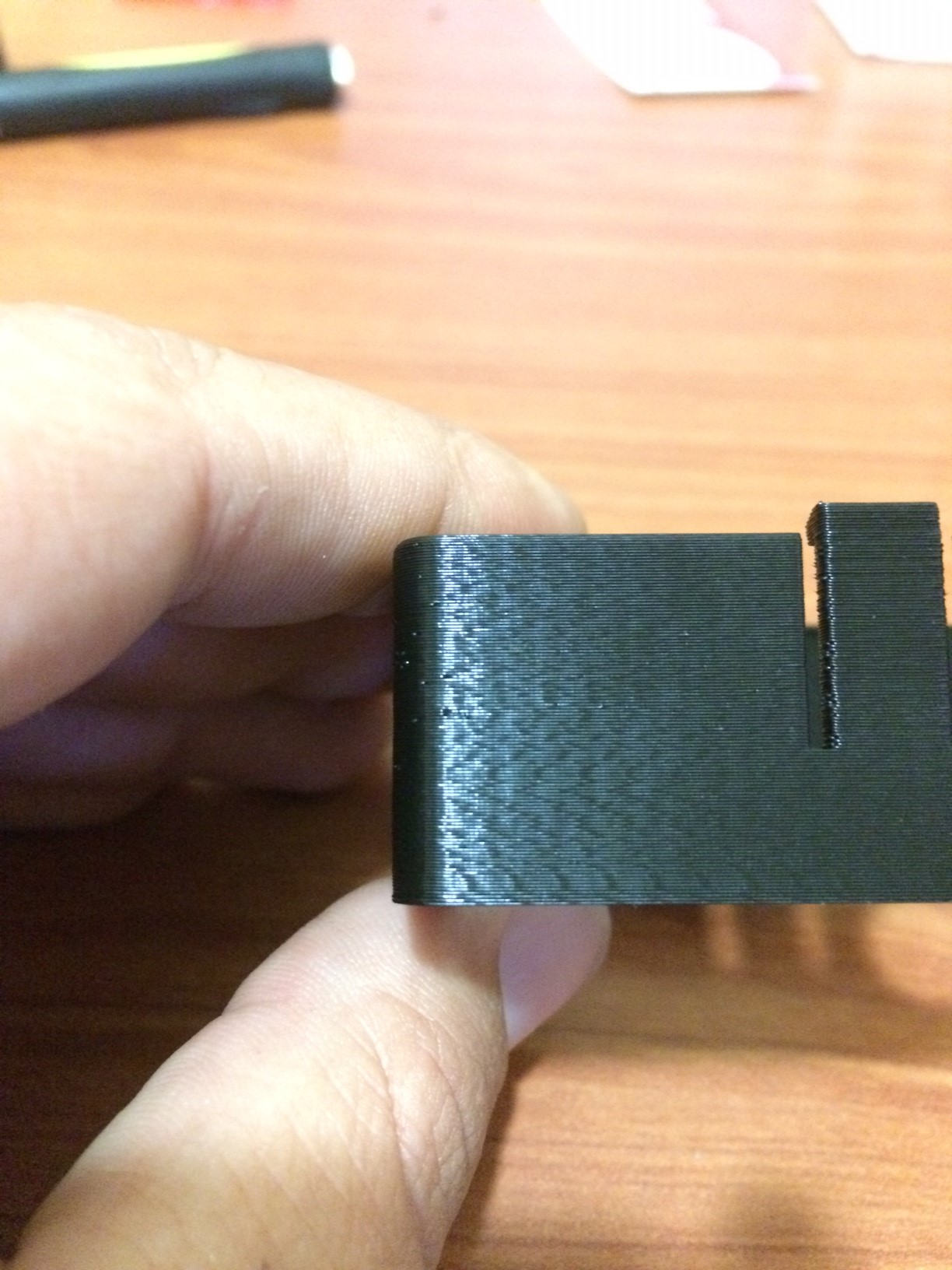

    Hi All,
    I just want to say thank you for this amazing design. I went and build the D-Bot design and am super happy with it. A week ago I went and changed the original D-Bot bowden to direct drive and I am getting now these ripples which I just can't get away. I tried the following:
    1) Super tightened my belts
    2) Tried smaller stepper motor - still quite heavy going at about 240 grams
    3) Swapping stepper drivers (using the DRV8825 set at 1/32)
    4) Changed stepper current
    5) Changed Jerk and Acceleration from high to low - no difference
    6) Tried printing fast and slow
    None of these made a big difference - only the tightening of the belts made a small difference. I then did a quick and dirty move back to bowden and the ripples were gone. Is anybody else having this, I really want to move over to direct drive. Is the only answer a pancake stepper or did somebody get success with a standard nema 17 stepper?

    I always used direct drive so I just assumed this was normal.. I believe I saw an improvement in these during my experiments with a wheel-less carriage, but I need to do more before I can confirm that

    Just for comparison, here is a pic of the same part (at bout 80% through when I canceled it) after I did the quick dirty swap back to bowden. The temperature was not right so that is why the part is shiny at the bottom and mat black further up - but the line as nice and smooth. I got some amazing prints with the bowden but I do not like the oozing/blobbing etc. I have the bowden tuned nicely but depending on what parts I print I sometimes need to change the retraction etc. . With the direct drive it is much nicer as for one setting for all and I want to start printing flexible filament .

    I'm running an E3D titan with a pancake stepper, and I don't see a pattern like that one mine, but any pattern is kind of hard to see on my prints besides slight ghosting, but the PLA I'm using isn't shiny at all at the speeds/temp I print at. My stepper + extruder + front carriage plate weigh a little less than a 42mm nema17 motor.
    I'm running an Azteeg x5 v1.1, it has DRV2285 drivers, at 24V.
    Something you may want to try, if you can, is to attach weight to the carriage, so it would be close to when you run direct drive, and print with the bowden to see if the pattern is apparent, if it is, then it's probably a weight thing.

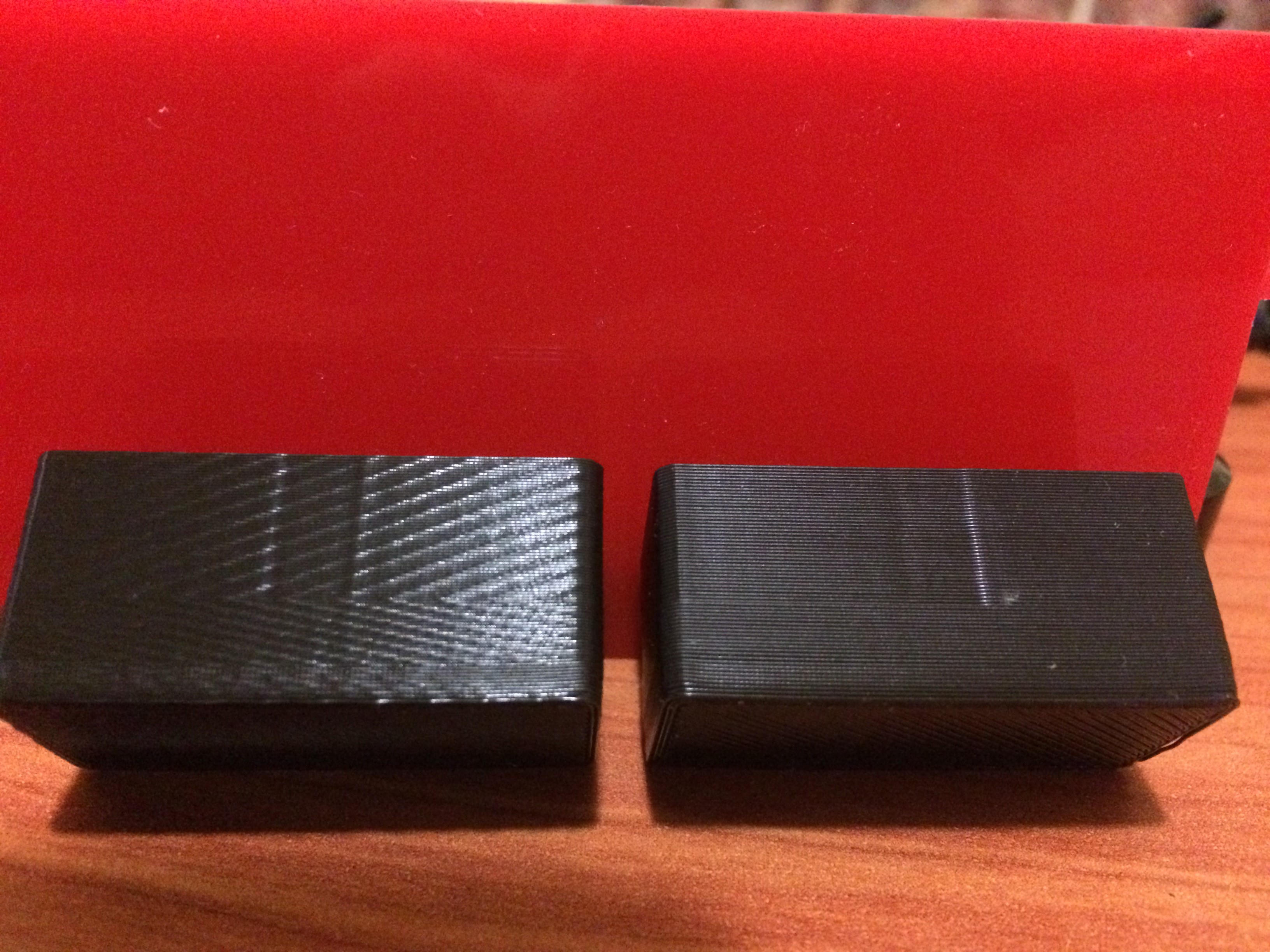

    Ok, I am back on bowden but kept the gantry the same - just moved the motor back to the side and fitted a new bowden for full length. I will start adding weights tomorrow - waiting for a friend to lend me a scale.
    Here is a photo of the same part with the direct drive print on the left and bowden on the right.

    What's really weird about those ripples is they appear to be diagonal.. The ripples I get with my direct drive are less pronounced, but vertical..
    It's hard to tell from the photo, are the ripples raised enough that the surface is bumpy?
    Also, do they appear along the X axis, Y axis, or both?

    Yes they are. One can feel them where as the other print feels quite smooth. Very strange pattern . Could the heated bed springs have something to do with it - not strong enough ? Just guessing here. Will see tomorrow what the adding wight does and from where it starts.
    And yes, they are the same on X and Y .
