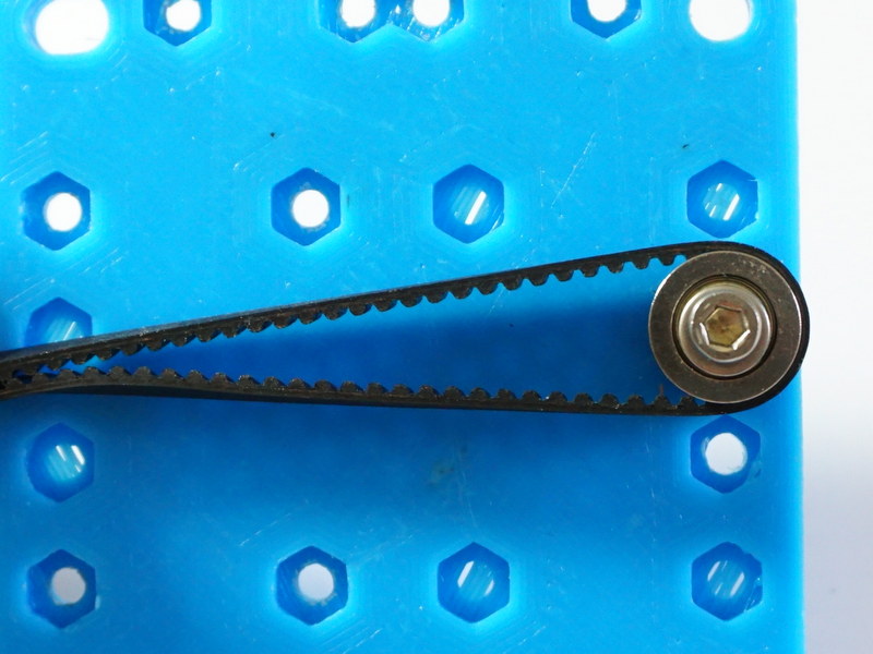

  14. CapnBry
    CapnBry Well-Known
    Jun 13, 2015
    100
    54
    I bought some of those grey polyurethane belts with the steel strands in them too, thinking they would be less prone to stretching when rounding corners and what not. Installing them you can tell the difference immediately, as you realize that the rubber/fiberglass belts stretch a lot as you pull them tight, these you pull taut and that's about as far as they're going to go.
    There is a problem with them and I'm not sure I can wrap my mind around exactly why. Some prints were coming out ok, but others were horribly warped.
    This is the orientation they were on the bed and you can see the bottom left corner, those are supposed to be straight lines. It is visible on the right side of the right print as well but not as obvious. Jogging the head from X=275 Y=150 to Y=250, the head very visibly does not go in a straight line. At different X values the deviation is more or less noticeable. For some reason around this point the belt is being pulled tighter by one motor than the other. It would seem that there's a "hard spot" in the belt and when it rolls over one of the bearing surfaces, it doesn't conform to the radius of the bearing and therefore takes a slightly longer path and produces bowing around that point. Visual inspection revealed nothing obvious.
    The fact that it only seems to occur close to X=0 and X=300 would seem to indicate it has something to do with the proximity of the carriage to the XY bar ends perhaps? That might be a red herring, as maybe whatever is causing this just happens to manifest itself there due to where it is occurring along the belt.
    I'm wondering if maybe these belts are designed for larger bend radii and they're not conforming to the F623 radius (5mm vs 6mm for a GT2-20)? They definitely don't bend as easily as the rubber belts. Of course I could have just gotten crap eBay-quality belts, which they are.

  16. Spiffcow
    Spiffcow Well-Known
    Dec 27, 2015
    214
    92
    Man, that's disheartening.. Maybe using idler pulleys on the bearings to make the turn radius uniform would help?

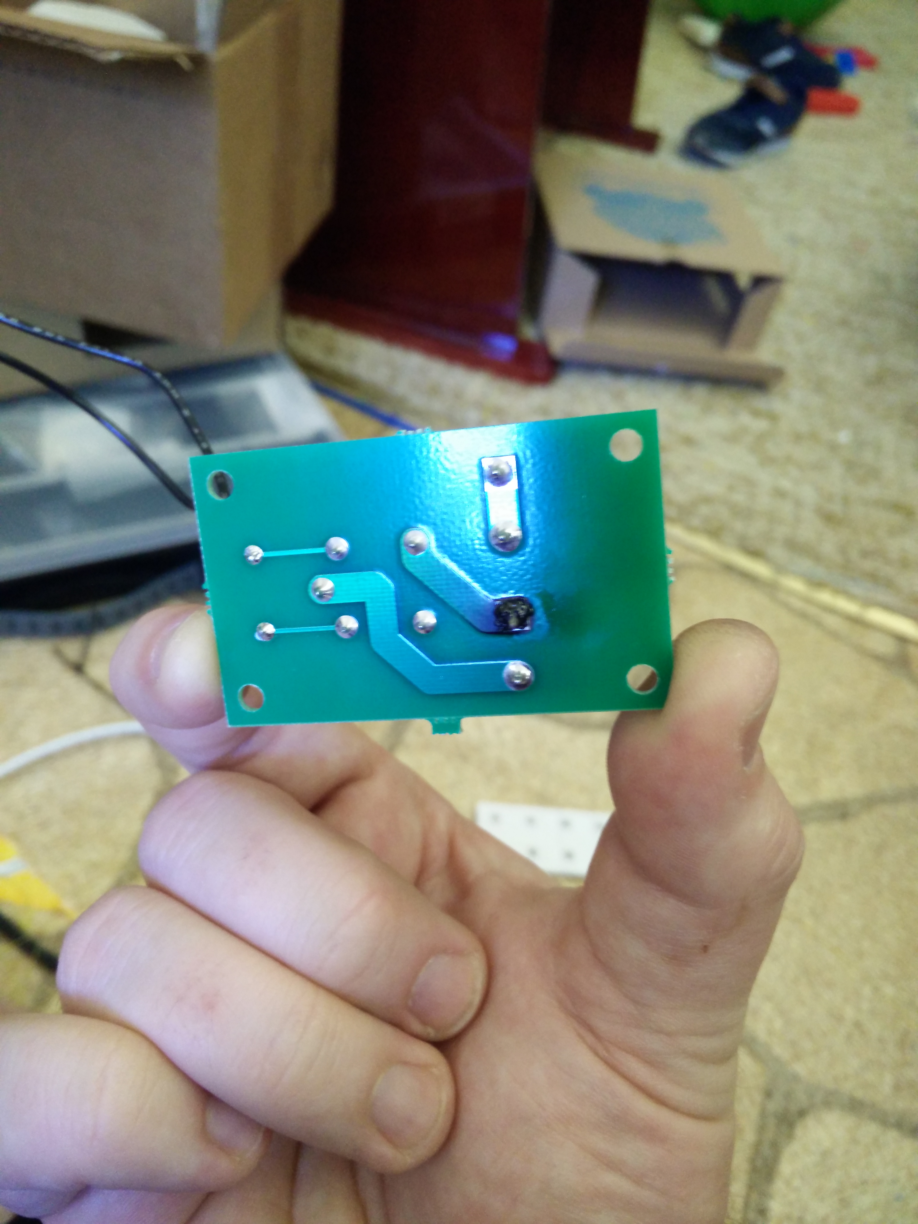

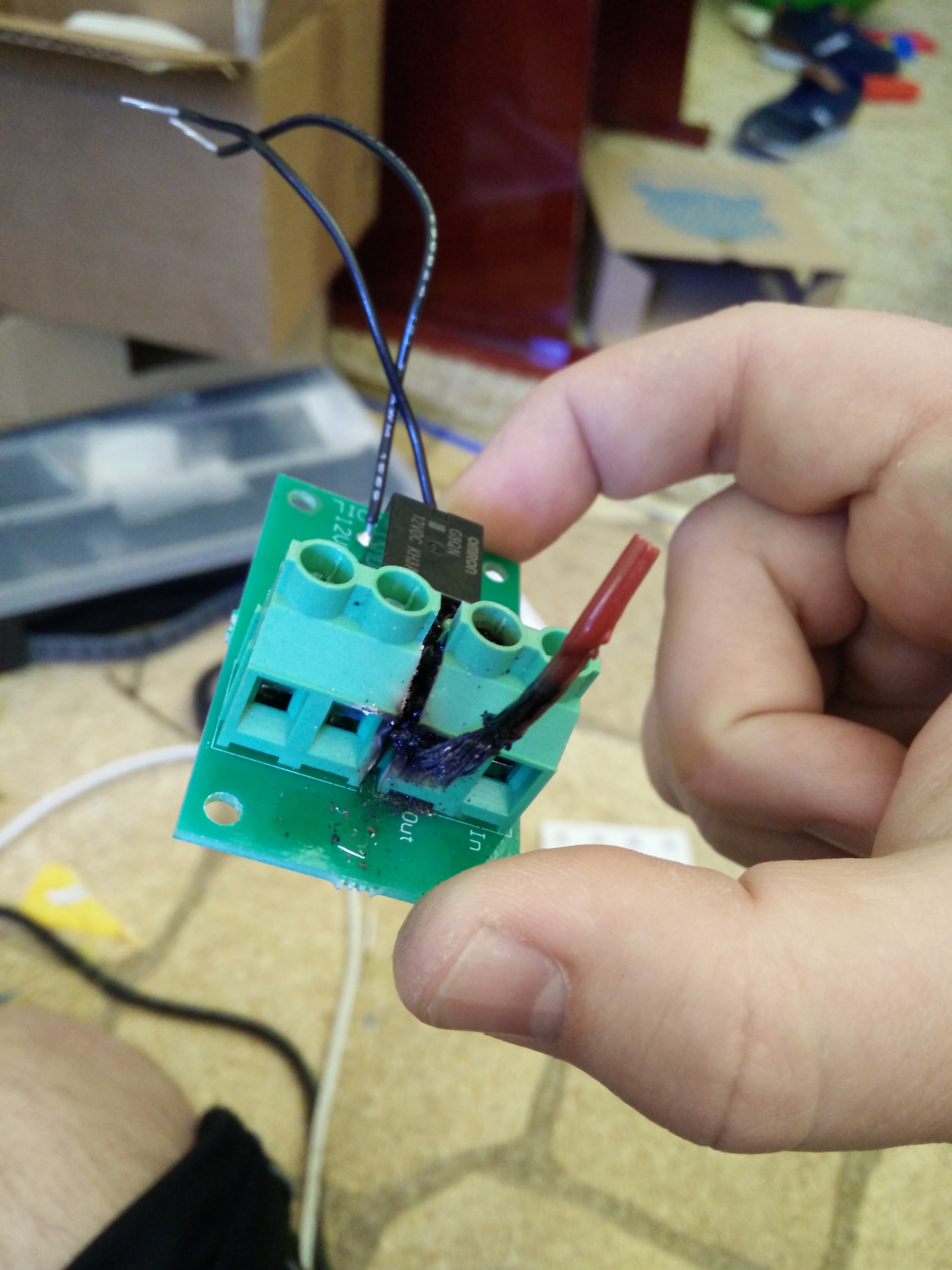

  17. Spiffcow
    Spiffcow Well-Known
    Dec 27, 2015
    214
    92
    I must be cursed.. Now that everything else is finally working, my power relay went and did this. Any reccomendations on a 12 V relay? Preferably one that holds up better than this POS from Makerfarm.

  19. AK Eric
    AK Eric Journeyman
    Mar 31, 2015
    179
    129
    Ouch, I've got the exact same one. It just dawned one me that I build my C-Bot one year ago this month (which means that relay of mine has had pretty regular usage for a year). Luckily that hasn't happened to me yet though...
    I'd be interested to know what people think are good SSR's: I feel like there has already a been a discussion on this...
    #2779 AK Eric, Jun 25, 2016

  20. Spiffcow
    Spiffcow Well-Known
    Dec 27, 2015
    214
    92
    I remember one on SSRs for AC output... I ordered a Fotek 25A DC to DC SSR... Hopefully it works out. I'm wondering if I should order a heatsink for it too... Do they really get *that* hot?
  21. Carl Feniak
    Carl Feniak Journeyman
    Mar 18, 2014
    654
    246
    mount it to the aluminum extrusion instead of getting a heat sink. Adam Cooks linked us to a conversation on low quality SSRs buring up. If you get a good one you'll be fine. I wired my SSR backwards and melted it, but my mechanical relay is going strong.

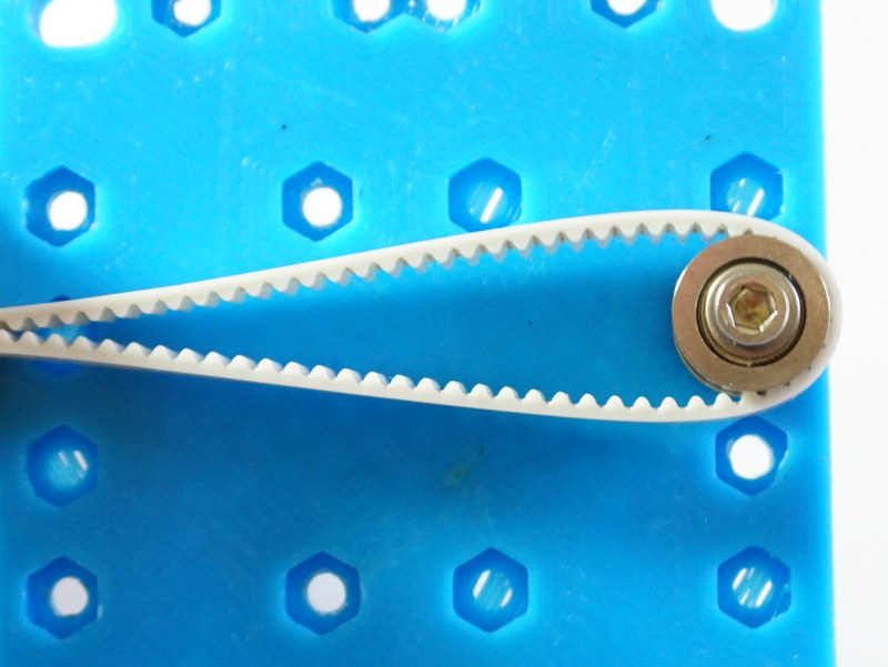

  25. CapnBry
    CapnBry Well-Known
    Jun 13, 2015
    100
    54
    It is possible. I have no way of determining exactly what the problem is, but swapping back to regular GT2 belts made it go away. If I run the steel belts through a little test rig made out of the 3mm ID bearings I can definitely feel there is a variable amount of resistance where some portions of the belt go around more easily than others. Visually, I can not see a difference in the belt at these points. The rubber belts can fold in on themselves with a radius of like 2mm max but the poly/steel belts are easily 2-3x that radius.
    See here with a tensioned belt, the white belt naturally wants a larger radius around the corner. I think in some areas, the belt is slightly more pliable and the radius decreases enough to pull things one way or the other (or maybe the opposite, the belt is more stiff in some areas). This is with roughly 8 lbs of tension force on the belt. Perhaps with a lot more tension you might be able to reduce it further, but you'd probably need to strap down the motors to the extrusion because this really starts to bend them outward under the belt tension.
    #2785 CapnBry, Jun 27, 2016
  26. Spiffcow
    Spiffcow Well-Known
    Dec 27, 2015
    214
    92
    Is that similar to how it looked around the motors? I'm wondering because that's the only place where it does a "U" turn.. The rest are 90 degree angles or very close to it...
    I haven't re-implemented the rear corners or the Y bar yet.. Maybe when I get to that part I can make the pulley profile variable so I can try a wider separation.
    I can't cancel my belts order at this point.. They're already on their way. I'll try them out and see if mine have the same trouble.
    #2786 Spiffcow, Jun 27, 2016

  27. CapnBry
    CapnBry Well-Known
    Jun 13, 2015
    100
    54
    Around a GT2-20T pulley it looks to be just about right with regards to the radius. That's a diameter 12mm - 2x0.75mm tooth engagement, so it is effectively only 0.5mm smaller than the 10mm diameter bearings.
    Running a quick 90 degree test, which I can't photograph without making some sort of vice rig to hold everything, it looks like there's still a tendency for the white belts to want to go a little wider around the bearing until a very unnatural amount of tension is applied to them and even then I'd question if they're really going completely straight. It is more force than I'd feel comfortable applying to the stepper mounts though unless there was a way to keep them from tilting inward.
    I wish there was a way to objectively confirm this though. I mean my printer was clearly swerving and I could remove and re-tighten the belts and it would still do it. However, there were plenty of areas where it worked just fine so it would be difficult to test for in a general case unless I could figure out what was happening.
    I do note that the belts at my carriage are over 1mm further out from the extrusion than they are at the XY bar end bearings which might be creating extra tension as the carriage gets very close to Xmin and Xmax which could account for an elongation along the X axis as it nears that point, but that does not account for why it only happens in a certain Y range (between 0.5 * Ymax and 0.75 * Ymax).
    I would say give them a try anyway. I mean the dimensions of our printers are quite different even if they share a common design. Maybe strap a pencil to the carriage and drive it around in concentric rectangles and see if any of them have deformed edges once you have it built?
