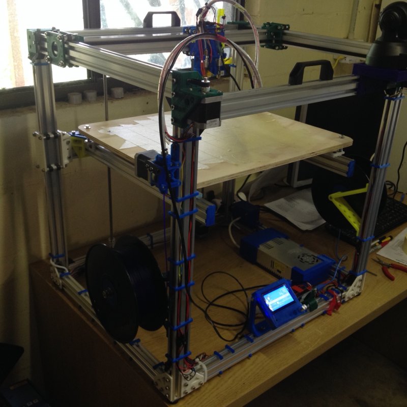

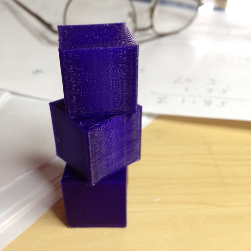

    Hi,
    I've finally got to the stage where I can do some printing, with my build.
    I'm currently printing eight times faster than I would on my Prusa I3, and it's giving much better results.
    Which is surprising considering I'm printing onto a piece of half inch ply, and I haven't done any calibration of the extruder or hotend yet.
    So well done Carl, I'm very impressed with your design...

    Looks great, love what you've done with the Z axis for the larger bed.

    Are you going to go dual extrusion eventually? I like the dual carriage more than the original, I should probably make a similar single hotend version.
    Is that an air-tripper filament drive?
    Now that I have moved my extruder to the front like yours it would probably be cleaner to have my ramps board there as well.

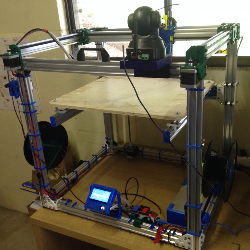

    Hi,
    Yep, I'll run dual extruders the new thermistors turn up, I only have enough to run one hotend at the moment.
    I had to make the carriage longer to accommodate the cooling for the hotends. Also I keep bashing the X endstop (or is it the Y) from homing the wrong axis first, I'll have to figure out a way to put the endstop on the carriage to solve this..
    Yep, I put a V-slot mount on an air-tripper filament drive and put one on each side.

    Hi,
    I'm using Aluhotend's, I originally had them on your dual carriage design, they fitted nicely although I had to reduce the groove mount by about 1mm, but then I couldn't manage to fit any cooling in. The smallest fan I have is 40mm and it didn't fit, so I expanded the carriage to get the fans on. I'm still tweaking how it all fits, and what works best.
    I got Marlin to home front/back (my Y) and then left/right, but occasionally I manually home left/right before front/back, or worst when it is in the left/right home and I home front/back it will bend the home switch, even more than it is bent now. Also my kids will be using the printer, and they are more careless than I am, it would be better if it's fool proof.

    Hi,
    The extra bracing on the front is to hide that gaps where extrusion joins, I didn't manage to cut it millimetre perfect so it has gaps everywhere :)
    I'm still working on the camera. I normally sit it next to my older printer so I have video to look at when things go wrong, but when I sat it next to this machine.... Well it looked up at the underside of the base. I built the mount for it, but now it is to close and all the images are blurry, I'll have to look at getting a different lense for it.

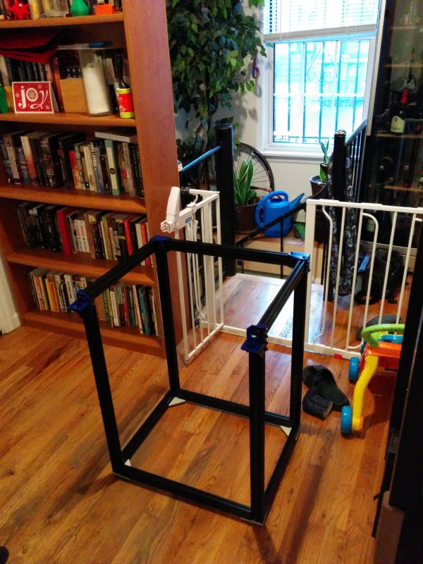

    do you know which LED strip you made room for? The 5mm 5050 RGBWW would be fun.
    As far as what the G does i dont know, I was printing on 70C glass with the aquanet #5. 240-245 nozzle temp, I used no fan, but removed my enclosure. Good adhesion, very little warp, good release from cooling plate. two warnings, It shredded the PTFE liners in my hot end, I used 3 inserts for the parts I printed. I got on average 20hours from one before I got some jamming. I have since installed some all metal, stepped bore, thermal barriers and have yet to get a good PETG print from it. I do think that the PTFE that I sourced was PFA, so many brands of teflon with different properties. I am going to try switching to a straight bore tube before going back to the ptfe, although I have two new sources of what I hope is ptfe. Second issue, I am getting some extra drag on my guide tubes in the last 20% of the spool. Esun does a good job of making sure the spools have a large center diameter, but there is a noticable curvature. I also just remembered that the spool has been out a while, I need to ask esun if it soaks up moisture. It is pretty dry here in NYC.
    With any luck I should get the frame assembled this weekend.

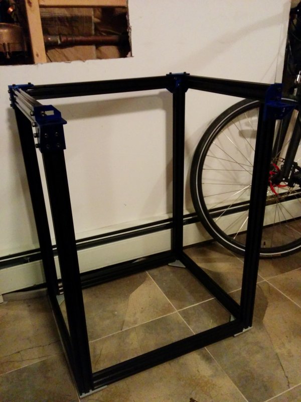

    I do think that the PTFE that I got was actually PFA, another brand of less thermal resistant teflon. Also the hot end in your E3D should be all metal? the ptfe in in the cold end? I know very little about the bowden setup.
    edit. I am printing with a makerbot clone, the ptfe extended all the way into the nozzle.

    The 90 degree brackets from the part store use M5 x 8mm, the 10mm's are too long. Ordered some proper black ones, going to head to home D for some temp one tonight. So far things have gone together pretty easily. Printed parts are spot on so far. and have needed no post processing. I did fail to measure my stairway, its a fairly tight spiral, and I had to take it outside to get it downstairs. whoops

    Looks great, that's huge! What length of lead screws are you using?
    M5x10 work with the printed corners. I thought the Open Builds store corners came with two flat head M5x8 bolts so I didn't think to mention it in the BOM. A quick check shows they don't. Oversight on my part (or they changed it).

    And unfortunately the 10mm bolts with a couple washers won't work as the bolt heads will collide. This is why I designed the printed corner to have a 25mm side versus the openbuilds 20mm side, it give the bolts some more room.
