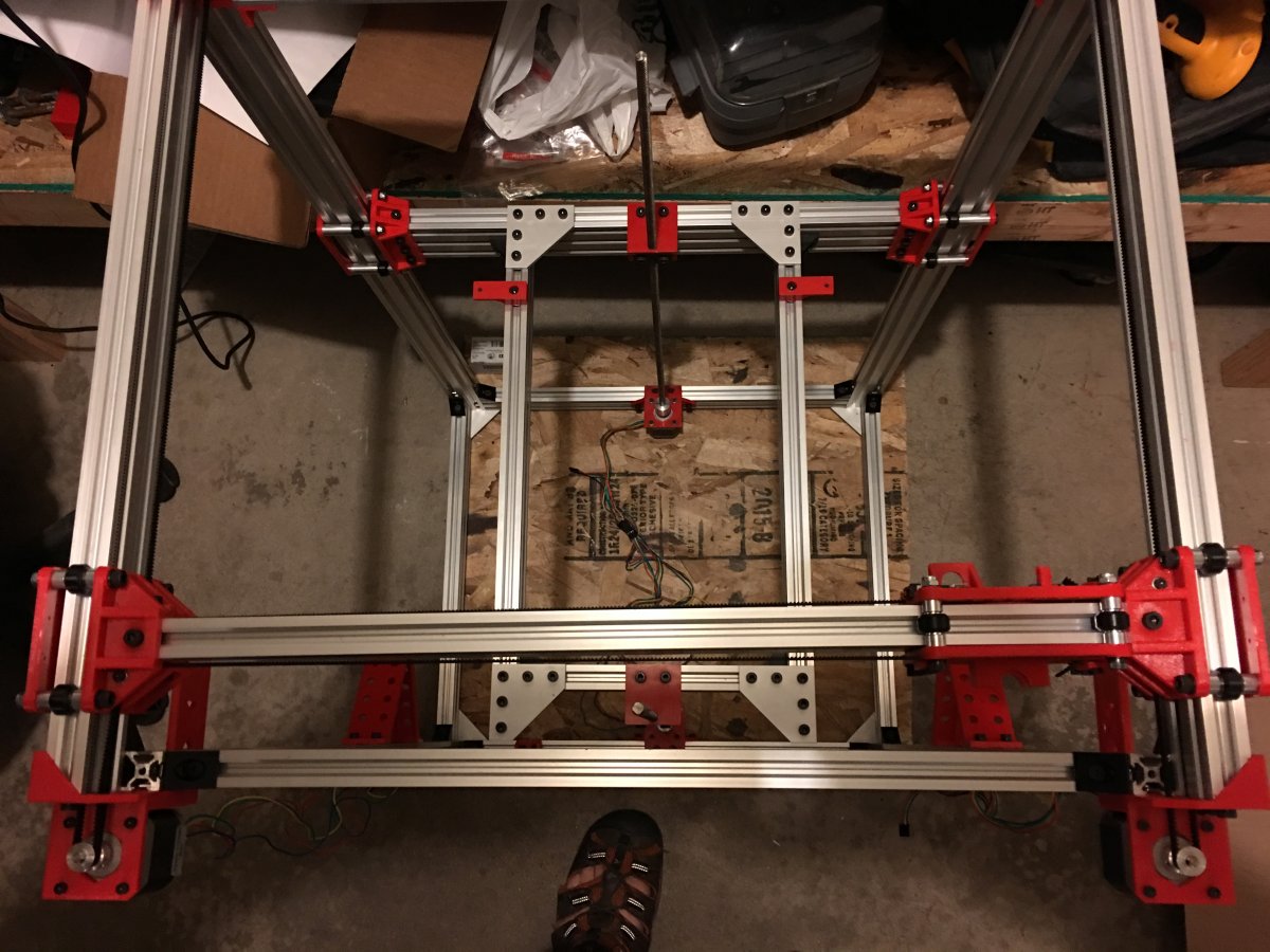

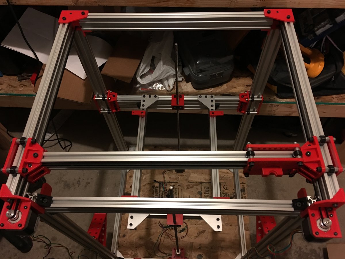

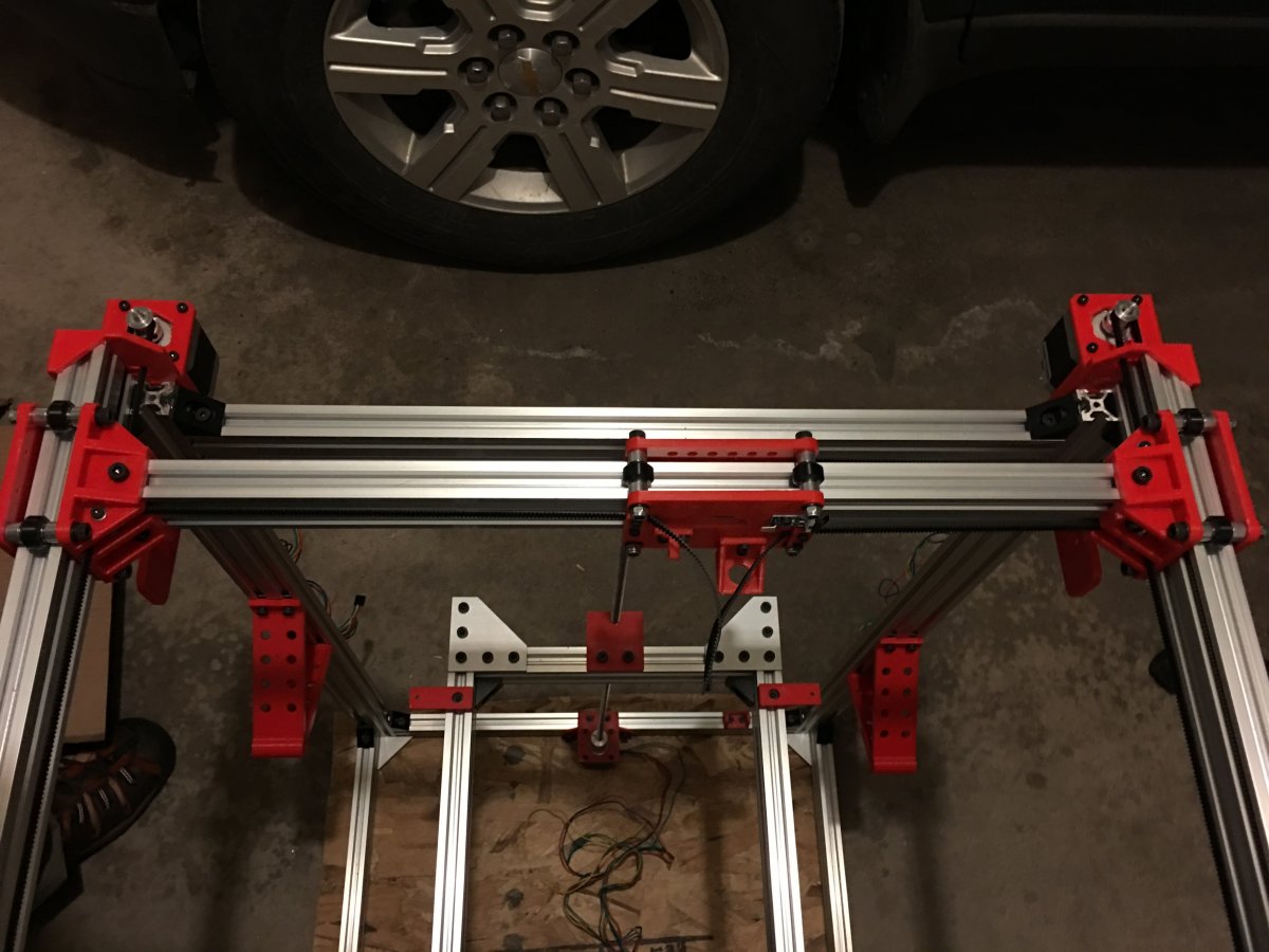

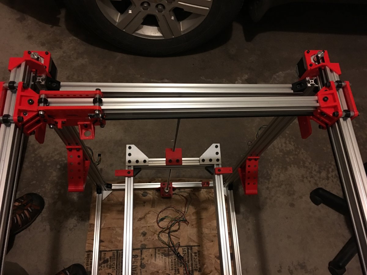

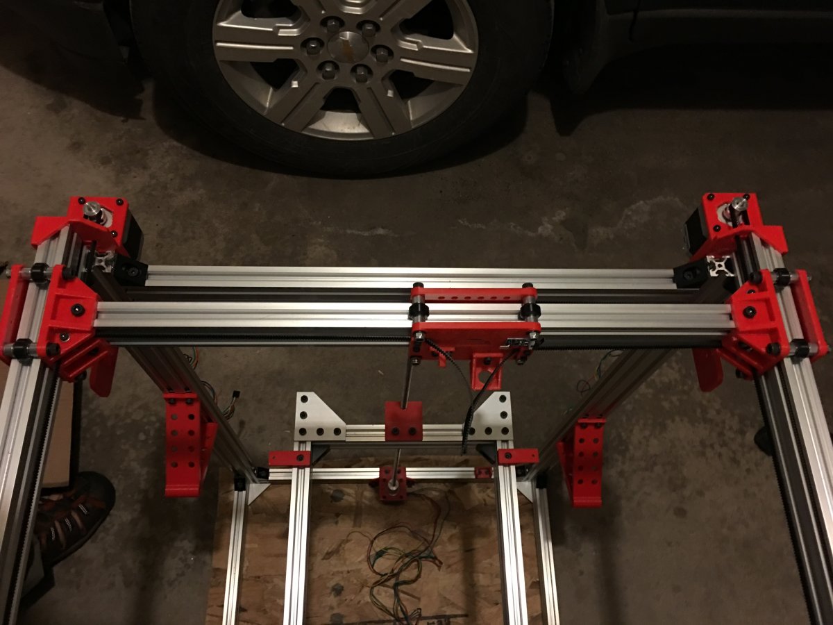

    Looking for some guidance on my xy gantry. I've assmebled the gantry and run the belts, but the gantry is not running even. I suspect the belts are too tight, but before I start tearing everything apart, wanted to check with you folks and see if any of you have run into the same issue.

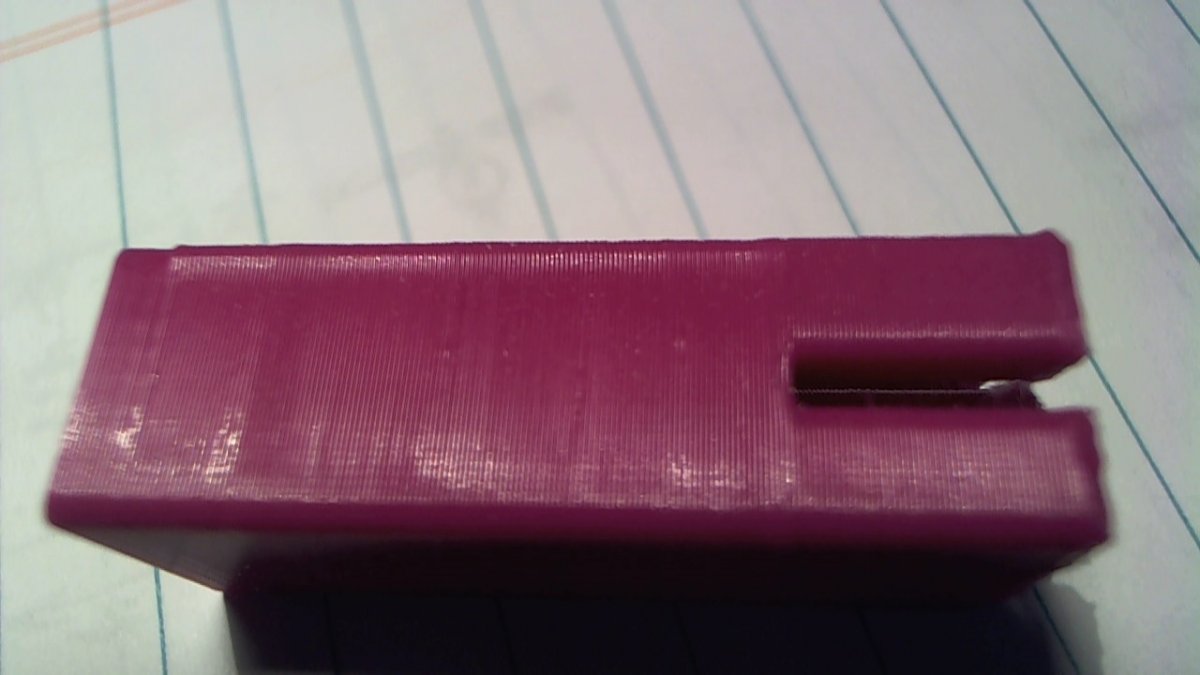

    Also Carl, in order to use a carriage mounted X endstop I created a little bumper that is added to the gantry mount. Giving you a heads to see if it makes sense to modify your design to remove the need for the little bumper or not, as it also changes the length of the screw and is only needed if you want to use a carriage mounted X endstop. The bumper adds 3 mm of material to the top portion of the area between the braces on the right side. You can see the X endstop switch below in the first photo, it's on the back of the carriage. Look to the right and you can see where it meets up with the bumper, the corner of it sticks out just a bit. For now I am just using one on the min endstop, but the code can add one for the max as well.

    Was it square before you tightened the belts? Did you tighten the belts one at a time?
    Loosen belts off at the rear of the XY carriage, leave the front ones fixed
    Loosen M5 bolts holding XY bar
    Tighten V-wheel end plate wheels and make sure they run smoothly
    Slide assembly to the front and square it off
    Re-tighten the M5 bolts
    With the bar still held in the squared off position, pass the belts through the clamps and catch the M3 bolts holding them (but leave loose)
    Grab BOTH end of the belt sections at once with needle nose pliers and then turn them to wrap the belt around
    This tightens both belts equally and at the same time so that the frame is not distorted
    Tighten the belt clamps .... with your third arm
    I can't see what you are describing with the end stops, but know what you mean. Though the way @adamcooks designed them that shouldn't be necessary, no? It should position the switch to hit the unmodified bracket.

    Hmm, an issue with the XY positioning then. XY plates still running smooth? Belts equal in tension?

    Carl, you sir are a scholar and a gentleman. Thanks! Your assumption that I tightened one belt at a time was correct. I followed your instructions to the T and everything is dead on even now.
    As for the bumper I was describing, I added a better photo of it below. Will look over Adam's design as well to see if I can adopt it. I can modify the depth the switch sits at. The current design only sinks the switch into the carriage by 1 mm, this is to leave some material between the nut trap and switch. When I mounted it up last night, the switch was not making reliable contact with the XY bar mount, which is why I added the bumper.
    Excuse the stringy print, I printed this in petg and printed it very hot to ensure good inter layer bonding. Guess I didn't clean it up as well as I thought... :)

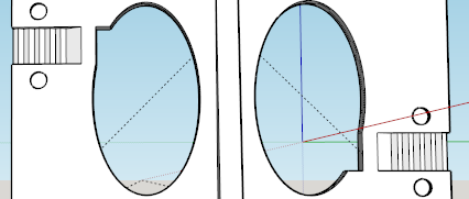

    Found an error in the bowden plate carriage. I had flipped the slotted holes from top to the bottom in the rework and there are artifacts in the nut catches. Until I get a chance to repost, here are the fixed files (I am gone for the weekend).

    Carl - I modified my plate long ago but never posted it b/c I couldn't figure out why it wasn't this way originally. Since it is still that way, maybe u can tell me. What I did was to make a cut out so the belt could go around the back side of the plate and have the teeth rest in the teeth of the plate instead of the smooth side of the belt on the teeth of the plate..
    This makes clamping much more secure and I am not tempted to screw so tight that I separate the part (which is why I had to reprint it.). It also lets the belt lie more in the rail groove instead of outside it.
    OH!, I just realized -- my unit is turned around so that the motors are in the rear, so for most ppl the mod would have to be implemented on the back piece.
    Do u want to add the belt clamps to these files also?
    I haven't followed all the chgs to these parts. What I just noticed is that the adj hole was moved to the bottom. What advantage is this? What other chgs have u made?
    thx

    Interesting, my only concern is that the moving idler pulleys are are aligned with the midpoint of the carriage plate. By wrapping the belt around the back the alignment is out (very small amount though).
