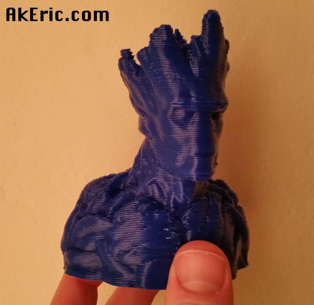

  9. AK Eric
    AK Eric Journeyman
    Mar 31, 2015
    179
    129
    Ha, that's awesome ;) Looking at the z18 print, you can see how the antlers get a weird faceting on top: It looks like they ran some sort of decimation on it first for some reason.

  12. AK Eric
    AK Eric Journeyman
    Mar 31, 2015
    179
    129
    FYI, since I switched to the direct-drive setup, I decided to mount the 1.2mm volcano nozzle on it. Here is my "calibraton Groot"... pretty happy with the 600 micron quality:

  13. Carl Feniak
    Carl Feniak Journeyman
    Mar 18, 2014
    654
    246
    Those are some THICK layers! And yet... a surprising retention in detail. Impressive. Using the large single rear mounted fan?
  14. AK Eric
    AK Eric Journeyman
    Mar 31, 2015
    179
    129
    Yep, single rear (big, 24cfm) fan. It's an interesting tradeoff in mm/sec I'm finding with the big volcano nozzles: Big nozzle = more filament = more to heat = harder to heat. I'm running at 30mm/sec, and if I push the fan up over 50%, the nozzle has a hard time keeping temp up, even though I have it surrounded with both ceramic insulation and kapton tape. But if I don't run the fan high, it doesn't cool the fine details fast enough. I tried running it at 45mm/sec, and I couldn't use the fan much past 25% before the temp started dropping. An interesting conundrum...

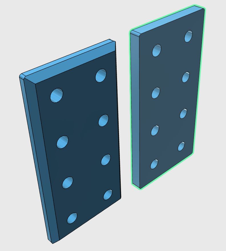

  27. Carl Feniak
    Mar 18, 2014
    654
    246
    Poll:
    What do you prefer...
    1) Simple Plate
    2) Plate with Chamfered Edges
    Chamfered edges are mainly just for aesthetics.
