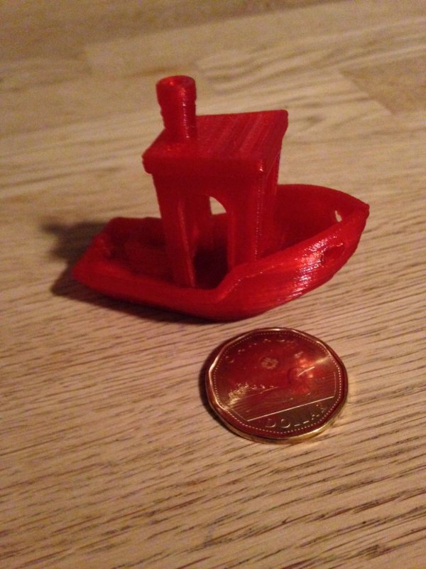

    Alright here's Benchy:
    Definitely not flawless but pretty good for a 0.4mm nozzle. This was done at 0.16mm layer heights in PLA. It actually looks better in real life than in these two photos. Only thing I don't like is the seem you can see on the front of the hull. Bridged the cabin ceiling very well. You can see the chimney is only slightly heat affected but pretty good considering how fast it would of printed.
    I think the torture test I linked to would be a bit of a waste as it has unlinked corners that don't bridge (look above my arrows)... my printer just isn't intended to print in the air!

    You sure that is your first print!?! **** good start. :) Interesting that you got the same horizontal seam that I did in the exact same layer.
    I think the idea is to print Benchy at whatever settings will give the best result to display what the printer can do (except no support!). Plus as a test object to see the result of playing around with different settings on yopu printer/slic3r. That said, I could of gone with an even lower layer height but I am not sure how that effects the arch printing capability. Better/Worse? Easy enough to test. I'll likely get a better surface finish in ABS, but it might crack since I don't have an enclosure.
    Looks like they actually do recommend 0.2mm layers as a starting point though:
    http://www.3dbenchy.com/3d-print/
    Don't see how you could get the rear letters to show up at that resolution, they are pretty fine.

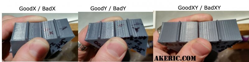

    So I got some success with the 'ringing/ghosting', blogged about the results here:
    http://www.akeric.com/blog/?p=3436
    The short story is: Reduced acceleration from 3000 mm/sec (which was the default value in the Marlin I have) to 800, and way better. Not perfect, but better. Since my bot is so tall, I plan to bolt it directly to the wall, and this should cut down on a bunch of the shake that's happening, and hopefully make the print quality even better. Thanks for the feedback everyone.
    Carl Feniak likes this.

    Yes, definitely a very notable change. On my OB1.4 I had to crank the acceleration down as I was missing steps on my moving bed axis, just too much of a momentum shift.

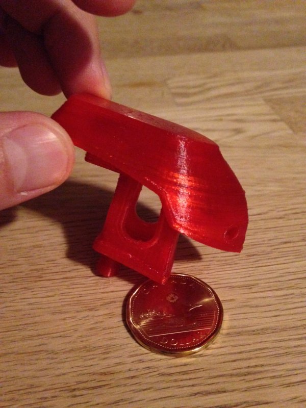

    Finally giving this a try. Had a nozzle jam in an interesting way earlier this week. Odd shape piece fell off above the heat break and jammed. Couldn't force it through since it wasn't getting enough heat, even with the fan off. Had to disassemble to clear it.

    Turned out decently overall, but the four cylinders on the underside detached from the bed early in the print so those areas turned out poorly. There was also some top fill gaps which I'd say is a issue with slicer. Could be narrow filament causing under extrusion, but I've seen this before with lower layer heights. This was done @ 0.12mm layers aside from the first layer that was 0.2mm.

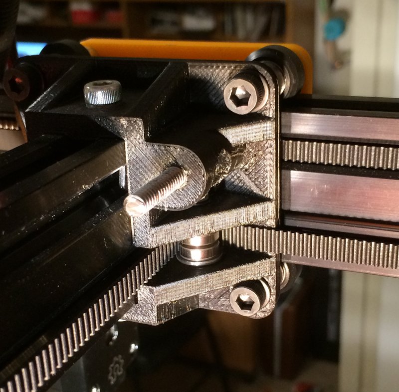

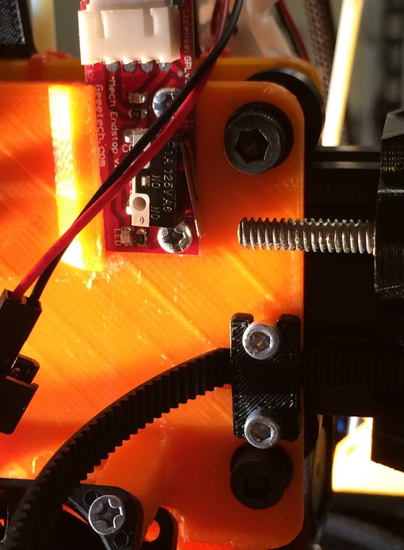

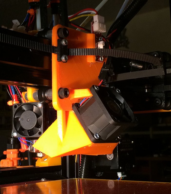

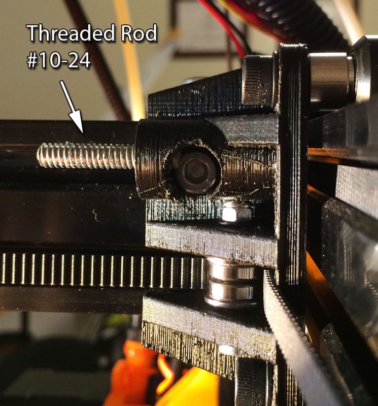

    I wanted to add a couple mods I'm working on. I started by attaching my X Endstop to the back of the carriage and added a threaded rod to the X End Cap. This gives me the most travel possible on the X axis. I modded the parts in 123D and subsequently converted the files to sat files for uploading to Fusion360. Here are some photos and files.
    The XEndCap.sat file was pulled from the remix of Carl's original from the 123D file. The threaded rod is inserted and adjusted after the end cap is assembled. The rod length can be shortened to clear the bolt if you like.
    This shows the mounted EndStop Switch (Geeetech Mech Endstop V1.2)

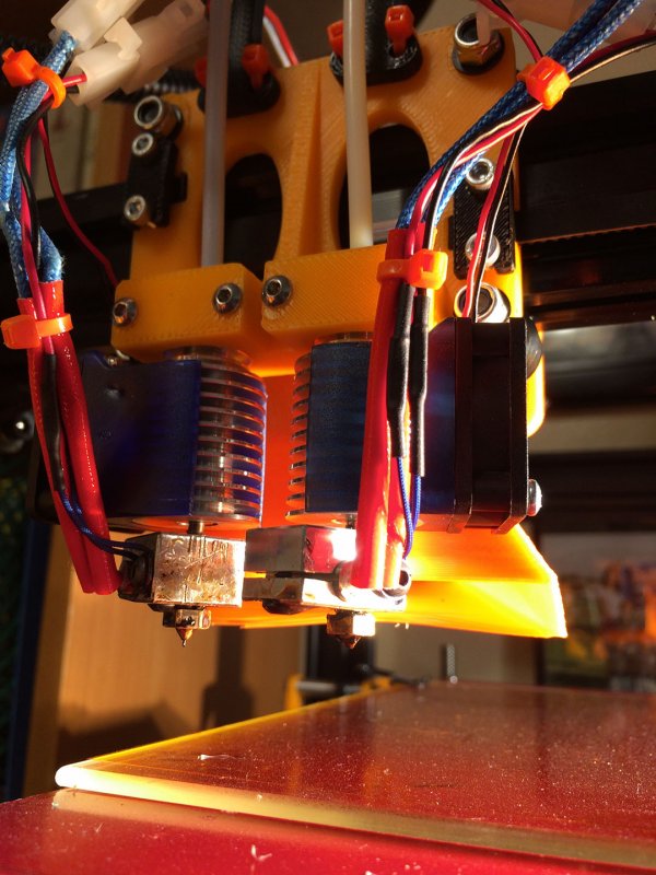

    The following two images show the fan mount and ducting for the dual extruders. The fan is having an effect on the heat blocks ability to come to temperature if I run the fan much above 20%. I'm thinking of wrapping them in some kapton tape to insulate them. Obviously, this is a work in progress.
    Comments and suggestions are always welcome.

    I like that endstop approach, I was experimenting with a way to put the endstop on the carriage but couldn't think of a good way to mount a bolt to the X end cap. My approach is below but I might try your threaed rod implementation.
    http://thingiverse-production-new.s.../79/33/c3/Dbot_Endstops2_preview_featured.jpg
  28. Val Cocora
    Val Cocora Well-Known
    May 19, 2014
    172
    28
    I also mounted the end stops on the extruder carriage. I am using a double extruder from Micron 3DP. Please see the attached pictures.

    Looks good. What orientation did you print the back place and fan shroud in? Lots of support?
  30. Raldan
    Raldan New
    Jul 5, 2015
    21
    20
    Yes, lots of support. I printed it on my Up! Plus2, on its back with the edge of duct touching the bed.
    I'm having problems with first layer adhesion (PLA) using Kapton and Aquanet. My white PLA (Matterhackers) practically dribbles out of the nozzle while the black PLA (Shaxon) dribbles out and clogs periodically.
    What bed temp and nozzle temps do you recommend? I'm finding a lot of inconsistency with the Matterhackers filament, as if the filament varies in thickness every 6 traces back and forth. What filament have you found reliable?
