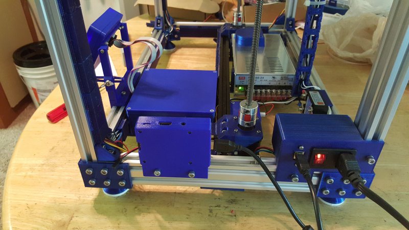

    Well, I think my build is officially completed. Everything is printed, attached, and working. Just need to do some calibrating. But couldn't wait and just tried printing anyways.
    Test print in action:
    Closer view of the dual hot ends. Can you guess they are E3Dv6? :)
    Back side of the printer. Used a cable chain to keep the wires to the heated bed organized.
    Power/Input panel on the right. Raspberry Pi/Octoprint on the left. Smoothieboard in the case behind the Pi.
    Full Graphic Display panel.
    Working on learning how to print with the dual extruders. I finally got Smoothieware and Repetier configured right, I think. Did try to print some test objects but the right side extruder is under extruding. Still need to get it calibrated.

  8. Carl Feniak
    Carl Feniak Journeyman
    Mar 18, 2014
    654
    246
    @Elmo Clarity
    Looks great! Very clean wiring and accessory casings. Where did you get your flexible couplings from?
  9. Elmo Clarity
    Elmo Clarity Journeyman
    Jan 17, 2015
    505
    149
    Got the couplings from http://www.amazon.com/gp/product/B00IJ67DMA?psc=1&redirect=true&ref_=oh_aui_detailpage_o01_s00. I first tried the ones from a seller by the name of SHINA STORE. They were suppose to fit the 8mm lead screw, but only had a 7.9mm opening. Had some issues trying to return them. Amazon took care of the issue and got my money back.
