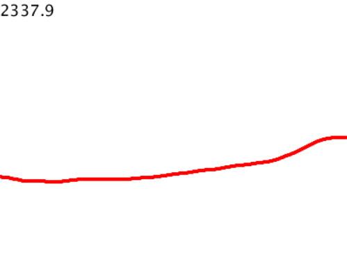

    No kidding, right? I thought for sure maybe some would be better than others but the first two are absolute garbage. I ordered one from Amazon that looks just like yours does Carl and it has actual grooves in it. I couldn't wait another week and this has been holding me up for like a month now, so I shipped it overnight.
    I printed the parts for Airtripper's filament pressure test rig and got some actual numbers.
    The first one, purchased from eBay seller sidewinderinc starts slipping at about 2kg (the graph scale is 0-5kg).
    Next the "special" one from eBay seller rp_one_labs which was able to achieve about 2.6kg of force before it started letting loose.
    Finally the new brass one from Amazon. The stepper started slipping at 0.5A ~3kg so I upped that to 0.75A. This one was hard to get a screenshot because the feedrate had to be super high to get it to slip. I think it was feeding 10mm/s at this point and pushing over 4.2kg.
    Printing some infill at 60mm/s I took this screenshot to show how the extruder temperature can affect the pressure to the point it slips. At 220C the large swath of straight infill runs about 1.8kg-1.9kg. Drop the temperature to 200C and the force slides up as the extruder cools, up to 2.3kg. I had been trying to print at 200C, and this is the point that the other MK8s were losing their grip. Surprising that PLA would need 220C.
    Yes I know that kilograms is not a unit of force, but you can convert it to newtons if you want. The relationship is the same. The device looks like this, which is hard to make out the parts on account of them all being the same color, but it is a mount that goes on the printer frame, with a load cell bar in it that the stepper motor is strapped to.
    The load cell is read using a cheap HX711 I got from eBay for a couple of bucks. I find the whole thing pretty fascinating watching the force/pressure on the filament as various features are printed. The infill with the temperature too low is really interesting because it doesn't just jump up to the full force, the extrudite coming out just doesn't keep up with how much the extruder is pushing so it steadily climbs until it levels out or starts to skip. Either way you're not getting the requested amount of plastic laid down.
