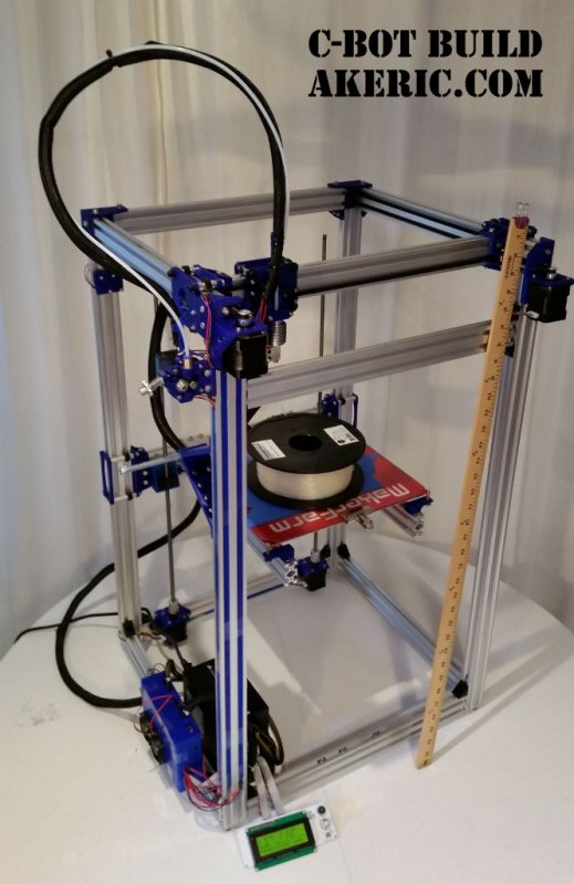

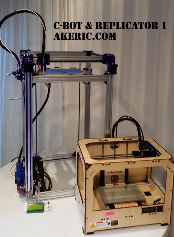

    Here's some pics of my nearly finished bot: I got the final wiring complete this weekend. Other than a tray for the power supply and a case for the LCD, it's complete (well, except for the filament coolers I still need to print). Been an awesome project, and a huge shoutout again to @Carl Feniak for the design and @sheffdog for all his help along the way!
    adamcooks, sheffdog, CapnBry and 2 others like this.

    Looks great! Glad that you tried that modification out on a larger bed, looks like it will work very well and is a simply change to the design --> don't need to print or order a bunch of others things to make it happen, just a bit more extrusion. Let us know if you have advice for others when you decide on a final position.
