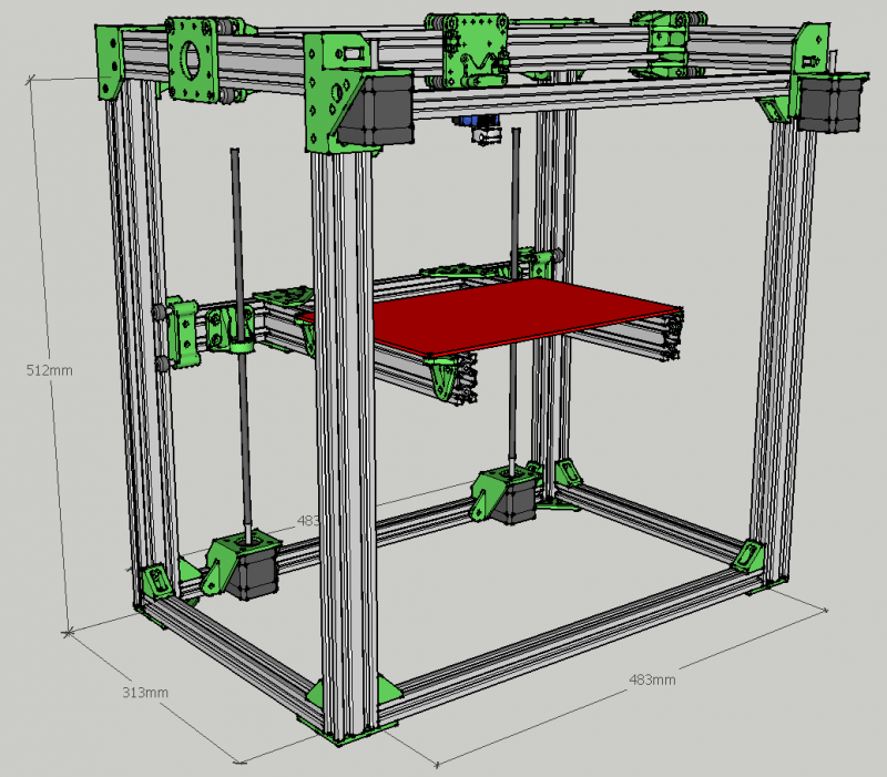

    I like that design. I may just have to rebuild mine to handle a 12x12 bed and use this mod. Would only have to recut the 4 side bars.

    @trublu832 Yeah I love it! Now I have a conundrum though because I was planning on building an 8x12 bed and now I've just ordered enough extrusion to go 12x12.
    I was planning on using an AC (120V) bed heater connected through an AC solid state relay because 12x12 really needs some juice to get it up to 100C. This 750W silicone heater seems like a little bit of overkill though. I'm going to contact them and see if I can get a little lower watt density. I feel like 400-500W would be a good number based on my current 8x8 bed's 150W (@14VDC). The silicone heater would be stuck to a 1/8" aluminum plate with a piece of glass on top.

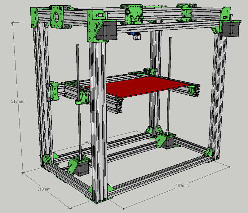

    Question to the community: I'm building a 12x12x24" version of this bot: Making great progress, all the hardware is built, I'm currently setting up the electronics.
    I've been tuning my stepper drivers, got the X/Y & extruder happy. But the z-platform is giving me problems:
    I'm using a Rumba board, with the A4988 stepper drivers that came with it: Currently, I can't get the z-platform to raise, only lower: I've been tuning the pot on the stepper, and it feels like there's just not enough power to lift it: If I help lift it (with my hand), it'll raise up. But I can't dial in any more power: It appears to be the max that driver can give. Like the printer build describes, I have both z-steppers plugged into a single stepper driver. If I decouple the the lead-screws from the flexible couplings, I'm able to move it up and down with little resistance. And while decoupled, both z-steppers move just fine. I'm able to raise and lower the z-platform by twisting the leadscrews by hand all the way up and down ( and 24" is a whole lot of twisting) without any issues I can discern.
    FYI, I currently have some DRV8825's on order: looks like they're 1.5A vs the A4988's 1A, so maybe it'll give me the juice I need? In the meantime I could actually use two stepper drivers instead, but I was concerned about possible sync issues?
    Any thoughts appreciated!

    That is probably your issue. When you have both steppers on the one driver, each stepper can only get half the current the driver can provide. So with only have 1A, each motor is getting 500ma, which isn't enough to provide the torque needed. What you need to do is run a second driver as a slave to the first one so each motor can get all the power the driver can provide.

    Nice blog! Has better pics than my build doc :) Sorry about the 55mm Z axis bolts mishap, I think may be part to blame there... 60mm bolts needed.
    If you do get one of the 8825s to test (or even still with the 4498), try loosening all the bolts holding lead screw nuts to the frame a bit so they can move and twist slightly. Also, make sure the lead screws are oiled. See If they will move then with some stepper tuning. I found any binding in the lead nut easily overpowers the stepper, even though I have a flexible coupling installed.
    To this day I only have two of the four bolts installed to attach each of the lead nuts to the frame (top and bottom on one side). You mentioned that you found an offset issue with that part. I originally didn't plan on sharing this piece as I thought folks would get the openbuilds derlin block. After it was requested I shared it, but didn't resolve that issue as I got it working... so if you have a fix please share!

    I'll have to do a little research on the Rumba board to describe it better, but you basically take the ENABLE, DIRECTION, and STEP signals going to the driver and connect them to another driver. I am using a Smoothieboard and there are headers available to do that. Not sure about your board.

    My bed is 12x12, the same as @sheffdog, and he has no issues with this same setup (his printer and mine are the exact same, other than mine is taller). BUT, he's running the DRV8825 drivers. And really, the weight added by a few more inches of extrusion plus the larger build plate (which is pretty light) seems negligible compared to to say, what Carl made. But what do I know? It's all just theory right now ;)

    @AK Eric I did some quick research on your Rumba board. While it would be possible to modify the board to do the two drivers/two motors by linking the control lines, given that it has 6 drivers, it would probably be possible to link them in firmware. You might want to bring this question up with maker of the board and see if anyone has already done that. Making the changes to the hardware is not something easily described in a forum like this.

    Just an FYI: I modified Marlin to support the "Z_DUAL_STEPPER_DRIVERS", and plugged my other A4988 driver into the Extruder2 block (Rumba supports three extruders): After tuning the trimpot, I was able to get the bed to lower, but not raise, even when there was no load (leadscrews were decoupled & bed raised out of the way). Come to find out, it looks like there's a bug in Marlin in that block that causes a conflict with "Z_DUAL_ENDSTOPS" being disabled at same time. I noticed this because while browsing the "Marlin Configurator", it's code section for setting up the z-dual-stepper-drivers differed (in the correct way) from the source I just downloaded from GitHub.
    Blah blah blah, long story short, I fixed Marlin, and now I can raise and lower my bed, including the glass plate. Yes!
    I still want to eventually drive them both off on DRV8825 to resolve any possible sync issues, but in the meantime this will do.
