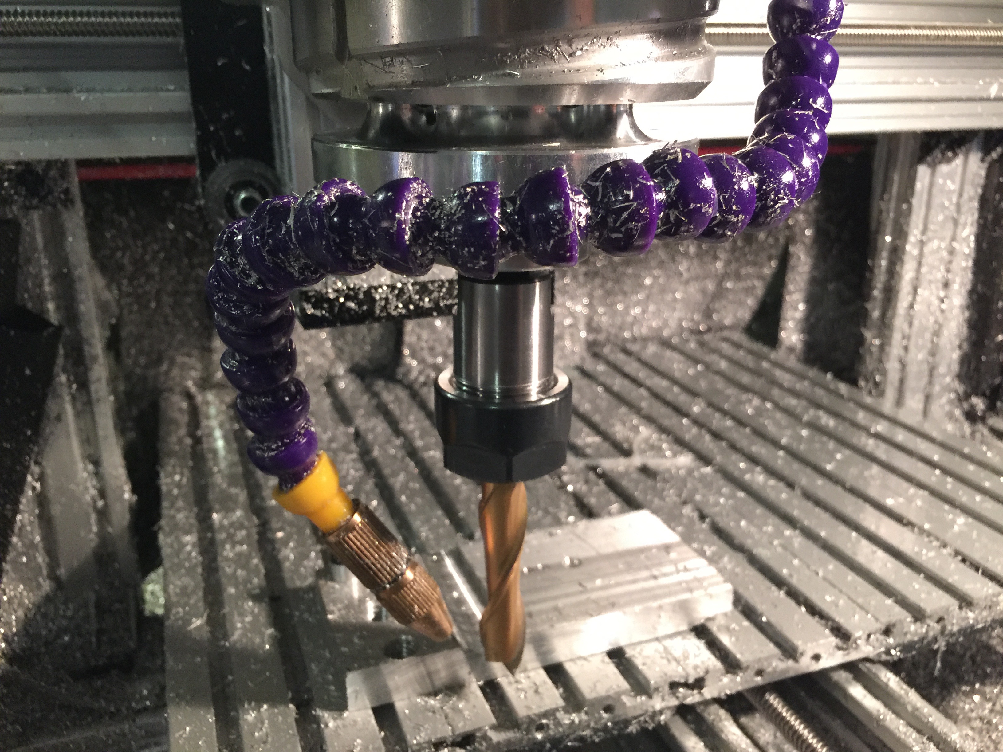

    Thanks.
    Here's the new plate installed.

    where did you get the ER20 adapter?
    Bob
  3. ymilord
    ymilord Journeyman
    Oct 2, 2014
    77
    159
    Designed it and had it made but the same shop that milled out the mini pallet for me.

    Well yeah. The whole point of getting that made and that thick was to get a absolutely flat surface to re-tram the machine too. Then having the 'pegs' and the threaded positions for easy registrations and part holding. especially for duplexed parts.
    I do have custom clamps and a mini vac table that can also adapt to the mini pallet.

    Hey folks, Can you give us the name of the company that made the ER20 collet for your dw618. I'd like to have one made too! Thanks
    Tyler
  8. wiremonkey
    Mar 23, 2017
    40
    Ah, nevermind, I found a straight shank collet chuck with a 1/2" (12mm) straight shaft and ER16 collet. I'm going to cut it down and see what the runout is on my dw618. I'll post results.

    Yup from CNCrouterparts.
    As far as mass-produced, That one pallet cost me over 200 bucks. The guy that machined the one said I'd have to buy over 100 to get a good deal. At any rate, I've migrated away from that mill. The work it's done (combined with my larger CNC) has allowed me to upgrade to a proper mill.
