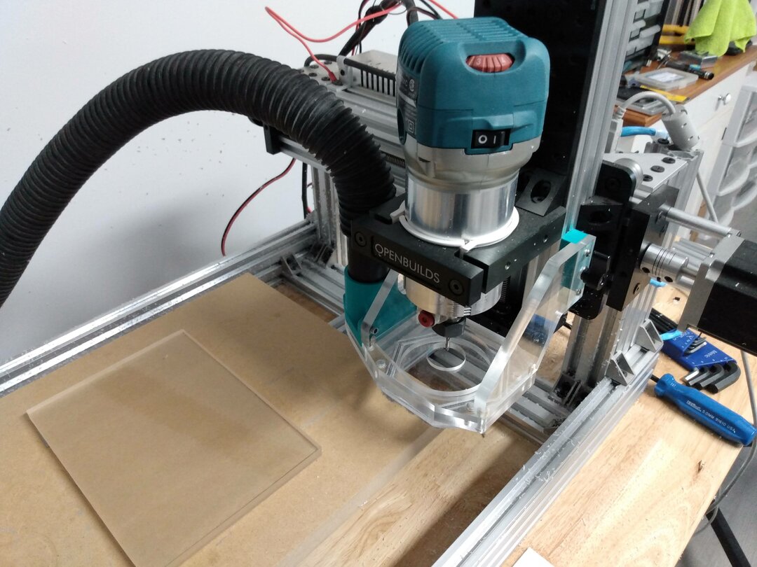

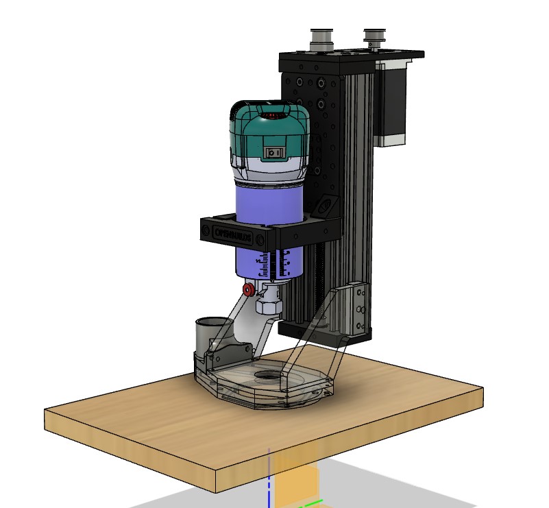

    If you decide to build a RIDE boot for yourself and have a different router (than my Makita), you should check the dimensions of your collet nut. I only have the Makita and I don't know if the RoutER11 or the DeWalt have the same size nuts. The design gives the Makita ~1.3mm clearance around the spinning nut.

    The RoutER11 should be compatible. The collet nut wrench will not work on my other machine with a Makita because it is too small. ;) Also, I thank you for saving me work. I was thinking of designing and building some thing similar since my previous dust boot is out of commission. Also, I wanted a see through design. I did not like my solid colored 3D printed design.

    My previous design was also all 3D printed and I hated that I couldn't see what was going on. I've been cutting a lot of acrylic lately (for other things) and the old boot just didn't handle acrylic chips well at all and they stuck to everything! So far I'm very happy with this one.

    I should also mention: if you have an OB led light ring, the wiring port will probably collide with this boot. You may want to cut out an extra notch in the side plate on that side.
