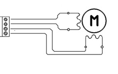

    So I have everything assembled now. The file idea worked great. No restrictions on my movement when doing it by hand. After downloading the software and trying to jog the machine, I found that my motors will not move. It seems like all of my axes are too tight. I followed the instructions for tightening the eccentric nuts. I can move all the lead screws by hand pretty easily. And I set up the control software as instructed from the black box documents. Any ideas what the issue could be here? I can't seem to find anything similar to this in the forum. Thanks in advance.

    I don't think your motors are binding, sounds like a step issue. Increase your steps/mm, also double check all of your wiring to the steppers. Although, I have been wrong before!

    Viewed the video, sounds like you have the motor wiring wrong. Either one coil is not connected properly, or the wires are mixed up.
    Make sure the coils are connected properly, and the same for all motors.
    And seriously, Romex for power wire?
    MG

    Agree, video sounds like swopped wires (1,3,2,4 instead of 1,2,3,4) or extremely low amperage (set current pots)

    Here are some more pictures. The Romex was due to me not having any speaker wire on hand. It is now the recommended 18 gauge same as the open builds website power cord. The pictures show my wiring connections. It is the same for all four motors. I'm not sure I understand how these are wired wrong. I followed the instructions for the black box.

    Check your motor wiring. I seem to remember that the High Torque motors use a different color code than the standard motors? Never go by wire color, always check. First time I wired up unfamiliar motors I blew 4 stepper drivers. Same color wires, different internal connections. Ouch!
    To check, rotate the motor by hand to get a feel for how hard it is to turn, May have to loosen the set screw on the lead screw. Now short any two wires together and try rotating the motor again. If the motor is much harder to turn, that means that the two shorted wires are the same coil. By elimination, the other two are the opposite coil. If not, try another pair of wires.
    One coil goes to A+, A- the other coil goes to B+, B-. Not sure how the black box is laid out, but the two A coil leads are next to each other on one side, the B coil wires are the other side. Don't worry about the + and -, the only thing that will change if you reverse them is the direction of rotation. You can fix that in the GRBL configuration. Wire all motors the exact same way.
    MG

  14. Adam Joseph
    May 7, 2019
    I will give this a shot tomorrow. Thanks for the advice.
