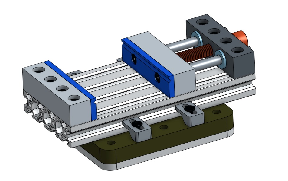

    Gino,
    That looks great!!! I think it will work great as well. I use parallels in my vise to lift the stock a bit but this would work for that also...I might have to make set out of Derlin Blocks with these lips ;) That's the cool thing about these little projects, so expandable and so easy to customize :)
    BTW: I love your renderings!!!
    Sonny

  6. GinoTheCop
    GinoTheCop Journeyman
    Jan 28, 2016
    149
    188
    Thats exactly what I plan to do.. Use drop in T-Nuts..
    The rails will be from local market here.. They are 15mm by 120mm with 8mm slots and they have M5 drop in T-nuts as well.

  7. GinoTheCop
    Jan 28, 2016
    149
    188
    An easy-lock option would be great bu I am short of ideas for that for now :sleepy:
    I will though reverse the rails so that they will have 3 slots on top instead of 4.. 1 less screw is going to be better I think..

  9. GinoTheCop
    Jan 28, 2016
    149
    188
    Hmm that looks promising.. Wish I could source them here.. but then again I just might..
    Something that would prevent the screw to release the t-nut would be far better as well. Coz.. you know when you turn the screw a bit too much to loosen the grip one of the t-nuts may be released and then I will have to undo them all 3 to "catch" the fugitive t-nut :)

  16. Sonny Lowe
    Sonny Lowe Journeyman
    Staff Member Project Maker Builder Resident Builder
    Nov 11, 2015
    143
    153
    Gino,
    That is so ironic, while out on my ride I was thinking you could modify a carriage bolt to look exactly like that...but this is so much better!!! Will it drop into the slots of your rail!?!? I just checked McMaster-Carr and the smallest carriage bolt they sell is M6 as well :(
    This is too much fun :D:D:D
  17. GinoTheCop
    Jan 28, 2016
    149
    188
    Yeah the rail is 8.2 mm wide and these are 8mm so they drop in perfectly :cool:
    Edit: I spoke too soon I guess 8.2 is the width of the lips alongside the rails.. The rails are 8 mm I believe.. I will have to go there and check and see to make sure :zipit:. But then again yeah this is so much fun :D

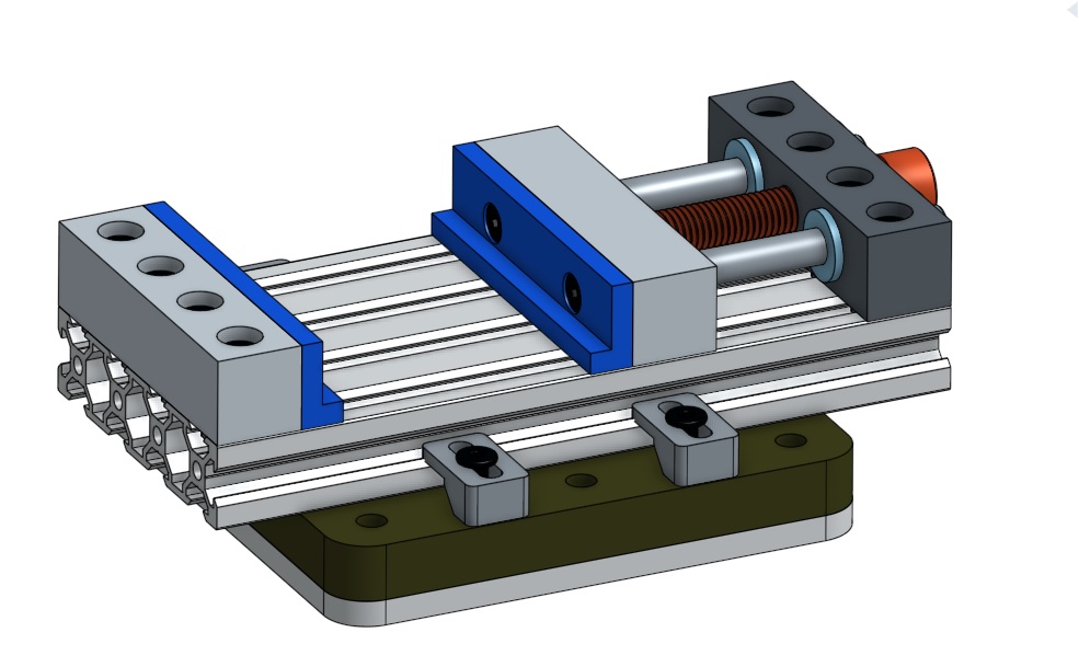

    Gino,
    I was thinking about your Jaw Mod idea (which I love) and thought this might be a nice compromise between either a Flat or L-Shaped Jaw set. Make a set of soft jaw, pretty much any shape you want and bolt (or maybe even double back tape) them to the metal jaws. This allows endless possibilities as far as Groves, Slots, Ledges, Etc.... Here are a couple examples, sorry no cool renderings from me LOL
  24. GinoTheCop
    Jan 28, 2016
    149
    188
    Awesome idea! Removable jaws for different purposes!
    Render is nothing compared to awesome ideas LOL
    Sonny Lowe likes this.
  25. GinoTheCop
    Jan 28, 2016
    149
    188
    This is my version of your idea.. For 15X120 mm rails..

  28. GinoTheCop
    Jan 28, 2016
    149
    188
    Hmmm. Collision alert!
    Carriage bolt + knob setup will cause Z actuator to collide with any knob taller than 7mm :blackeye:
    I guess will have to move back to drop in t-nut + low profile screw setup..

  30. GinoTheCop
    Jan 28, 2016
    149
    188
    And the solution is using M6 dome nuts (DIN 1587).
    The tool diameter to tighten/un-tighten is 14mm. The hole diameter I made is 16mm so this should work. And it should not be too difficult to tighten these down.
    The dome nuts stick out like 2mm from the blocks so no Z clearance issues.
