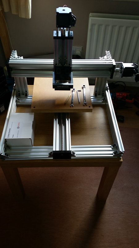

    I started tinkering tonight putting bits together, seems easy enough, i'll attempt to post a couple of pictures here and see what happens :)
    20150916_161631.jpg 20150916_230225.jpg 20150916_230225.jpg 20150916_230225.jpg 20150916_230239.jpg 20150916_230250.jpg 20150916_230323.jpg 20150916_230250.jpg

    Do your lead screws move properly to the end of the travel ?? it looks a well packaged kit
    Ryan Lock likes this.
  11. shugster
    shugster New
    Aug 22, 2015
    94
    20
    Hi Flash, yes i think everythings adjusted properly, i 'm just going by 'feel', i'll find out once its all together. The packaging and labeling is superb, everything seperated into packaging for each part of the build, im chuft because its making my job a lot easier. I have done another wee bit of the build today as you can see in these pictures 20150917_125340.jpg 20150917_125409.jpg 20150917_125356.jpg 20150917_125340.jpg

    well guys, i got some more done last night so ill post another picture...... 20150918_091045.jpg

    couple of things i noticed on the c beam, the aluminium plate the mdf sits on is quite thin, also the holes on the outside edges that we have to drill out are too close to the edge, i opted for bolts instead of the screw, there are 8 of them so it will be secure enough anyway. the rest of the build went smooth.

    that's the one. if the plate was an extra 6mm overall it would have better. i'm not complaining at all just making an observation:)
