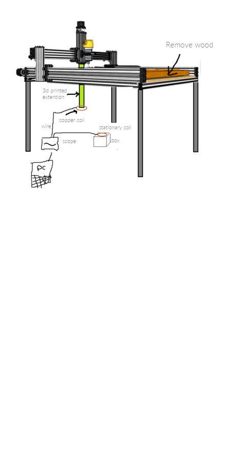

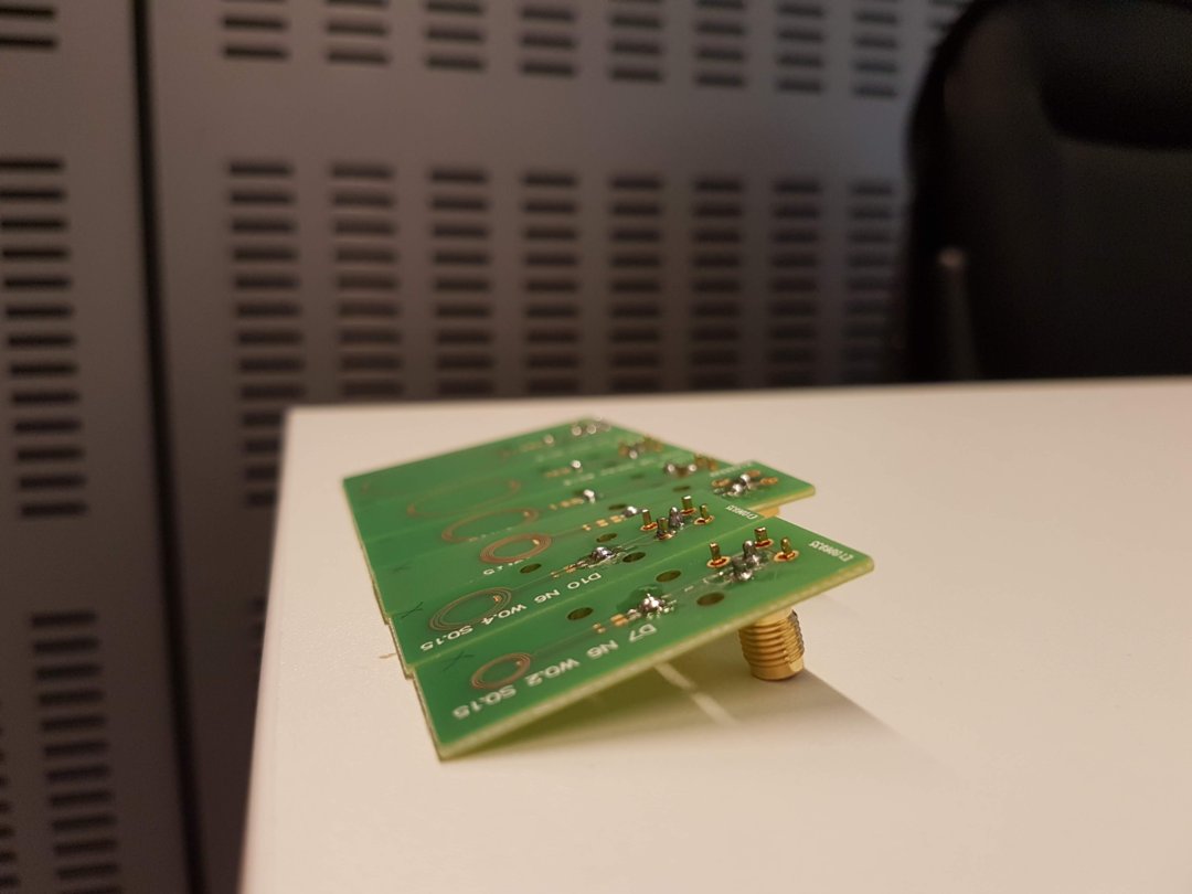

    I am building a positioning system for measuring the efficiency in energy transfer between 2 coils (inductors), in multiple positions.
    I've bought the LEAD CNC 1010 with the Arduino Compatible Motion Control System (Crowduino with stepper motor board using GRBL).
    My intention is to
    - Do a few modifications on the LEAD CNC as you can see in the pictures.

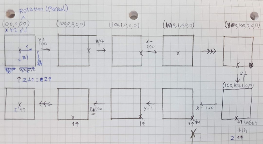

    - Position the 2 coils (stationary and moving) close to each other and SET this as a ZERO POINT
    - Execute a program which will
    1. Move the moving coil x mm (let's say 100mm) right on X-axis. In steps of 1 mm. And at each step, it will pause 0.5 sec
    2. Move the moving coil 1 mm down on the Y axis
    3. 100 mm left X-axis. In steps of 1 mm. And at each step, it will pause 0.5 sec

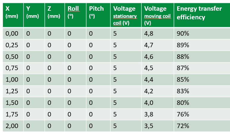

    In those pauses, a program (Probably codes in Python) will read the oscilloscope's channel 1 & 2, which the coils are connected to. And write the values of channel 1 & 2 in an Excel table (or other table).
    I would like the coordinates of the CNC to also be written in that same Table.
    So that I can just hit START. Come back 30 minutes later and the efficiency at every coordinate is logged into a table.

    2: no. because you need coordination between the gcode that is sent to move the machine and the oscilloscope reads and the file writes, you will need a custom program for this. I would use Python because the basics of communicating with GRBL already exist.... gnea/grbl .. simple-stream
    3: grab a copy of the simple-stream script and add what you need. you may want to create a function from the existing code called something like 'talktogrbl(x,y,z)' that will make the machine move and return true if all is ok.
    talktogrbl would send a string of gcode like this
    G1 X{} Y{} Z{}
    where the {} are replaced by the numbers given to the function. you will need a header and footer to safely set up and stop the machine, look at any existing Gcode for details, such as that produced by cam.openbuilds.com
    then the rest is something like (pseudocode)
    Code:
    sendheader()
    positions = array of places to go as x,y,z tuples
    for position in positions:
       talktogrbl(position[0], position[1], position[2])
       result =  measurecoil()
       writetofile(position,result)
    sendfooter()
    writetofile will write the given position and result as a CSV string to the output file.
    Excel knows how to read in CSV files (-:
