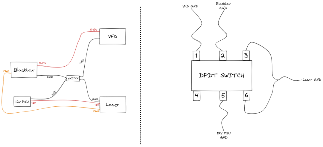

    Hey guys, just trying to double check I have this right:
    To use 12v laser & VFD / Spindle at the same time three things are needed, one being changing to laser mode in GRBL, the other switching power from one to another and finally removing the Relay Mode jumper (saw in the documentation for laser, I assume has no impact on the spindle?)
    Do I have it right in this diagram using a DPDT switch?
  16. Peter Van Der Walt
    14,028
    4,119
    As the laser is PWM, spindle is 0-10v its already seperate interfaces. No need to Control the signals. Only power on the relevant device. Vfd off, laser on = laser. Laser off, VFD on = spindle mode.
