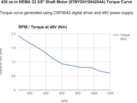

    On my initial setup, I had two V-Slot Linear Rails sandwiched together. Router was mounted on V-Slot Gantry Plates with Xtreme Solid V Wheels. I had a problem where the gantry was warping when cutting hard wood and even worse when cutting aluminum.
    I replaced the whole thing with a solid 12 x 54 inches x 1/2 inch aluminum plate, added a 80 mm spindle and everything was moving using a SBR20 linear guides. All this added a lot of weight, but I never encountered any flex after the mod.
  11. Denis Lapratte
    Jan 4, 2015
    27
    Below are the specs of my motors, very similar to sitoru and you said they were good.
  12. Peter Van Der Walt
    14,571
    4,230
    All mechanical components set up optimally? Not too tight? No whipping etc
    What other 3rd party parts are in the mix? (For example, like Sitoru had 5mm pitch Ballscrews instead of 8mm pitch leadscrews)
