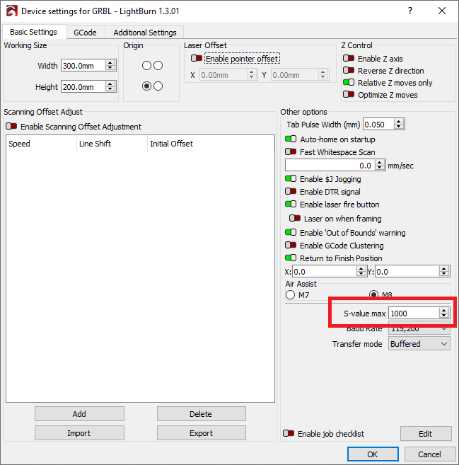

    Is there an easier way to change GRBL settings?
    For example I carve out my project with the CNC and have $30 at 24000, now I want to Laser part of the project with another design but I need to manually go in a change $30 to 255 for the Laser. Then change it back to 24000 for the Spindle to cut the project out.
    I guess Im just looking for a short cut to change this setting if there is even an option to do that.
    14,701
    4,249

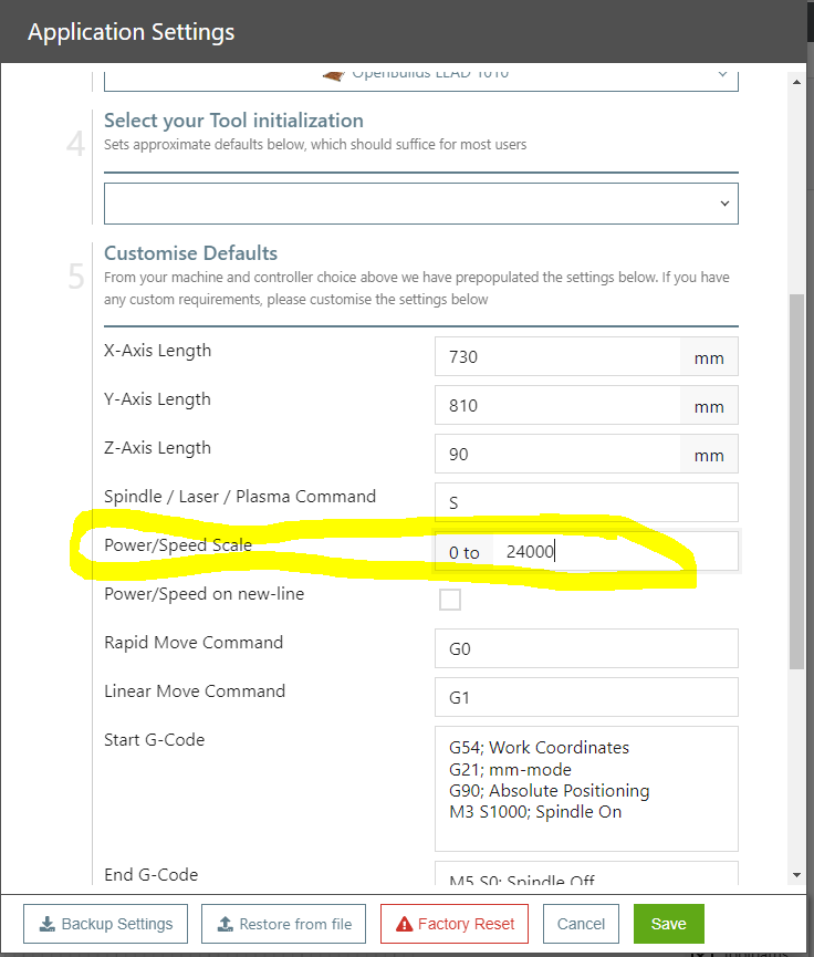

    Or even better - just configure your laser CAM workflow to output 0-24000 as well (instead of 0-255)
    Then the Grbl Settings stays consistent and both CAM workflow outputs the right values
    If its Lightburn its called "S-Value Max", in the Device Settings - change that to 24000
    _______________________________________________
    If you are using OpenBuilds CAM its in the Settings tab > Settings button window
