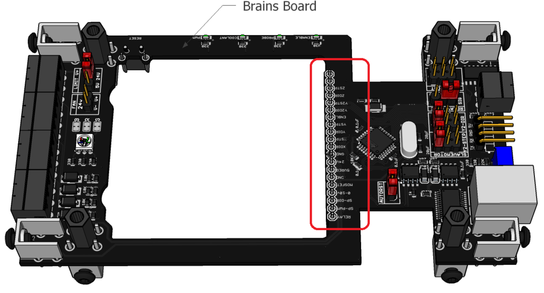

    So i have one of the original bb's (the one where you had to assemble it). I was wondering so I can use a "hi-torque" stepper with higher voltage can i grab a step/dir from the bb? I would be using 4 drivers (2-y, 1-x, 1-z).
    14,002
    4,113
    The signals are available (and labelled) on the Pin headers between the boards, so if you want to solder to those, you can pick it up from there.

    Thanks, Any chance can you send a pic of it?
    14,002
    4,113
    It's printed on the PCB:

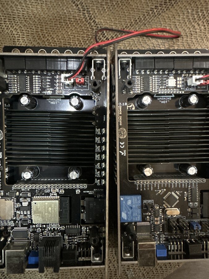

    I can see header on the the BB32 but without detail on them like BBx4
    not sure if they are same arrangement or how to know each one for what
    i need to connect external driver for Y only

  7. David the swarfer
    3,279
    1,836
    have you looked at the other side of the board?
  8. Mohamma393
    Oct 18, 2022
    73
    what i see is they are same but I know I’m not smart enough
  9. David the swarfer
    3,279
    1,836
    BETWEEN the two boards, mine is labelled there
  10. Mohamma393
    Oct 18, 2022
    73
    Ohh thank you , will see now :D

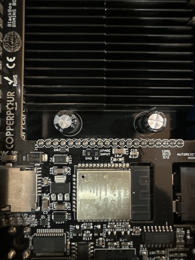

  17. David the swarfer
    3,279
    1,836
    i cant read the labels in your photo, too small. but at least one of those pins in a signal ground, use that.
    I don't know if the BBx32 shares an internal ground between the signals and 24v psu, I havn't seen the circuit diagram yet
    maybe @Peter Van Der Walt can tell us?
    Mohamma393 likes this.
  18. Peter Van Der Walt
    14,002
    4,113
    Yes there are GND pins in the interconnect.

  19. Mohamma393
    Oct 18, 2022
    73
    Thank you @Peter Van Der Walt @David the swarfer
    Yes i can see clearly GND pin above X DIR
    will solder wire to it
    Just thought i can use any GND on the BB
    Past week think to keep the new controller in a storage cabinet, really appreciate your help
