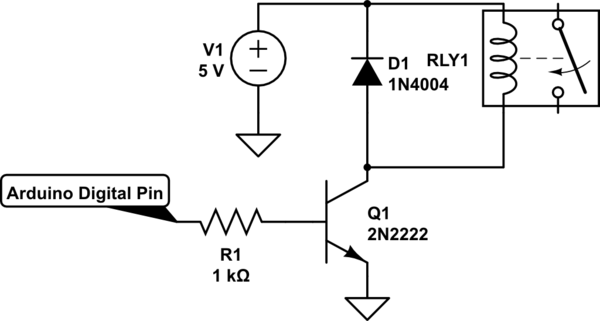

    I was going to get into eagle and draw up a schematic for this circuit, but I think I found a good example of the circuit your describing. Replace the Arduino Digital Pin reference with the 0-10V signal, and then share the grounds as you suggested.

    I've tested using the onboard relay, but it is cutting out at about half of the spindles RPM range. I suspect the internal relay is being driven by the 0-10V signal and that when I adjust the RPMs down below a certain point it going below the relay's drop out voltage, it's just a suspicion at this point, but that would match the behavior I'm seeing when testing it.

    Not knowing what the 0-10 V output can source in terms of current I would be inclined to increase the base resistor from 1K to 5K.
    Otherwise that looks right.

    Grbl only has one spindle output. The relay is already driven by a Transistor Alex. The problem is the pin outputs PWM. Of course the relay will chatter at lower RPM values, so its more of a 'use the relay (actually there as a plasma trigger)' or use PWM, but both wont play nice

    We added the relay as a) plasma trigger (no pwm at play) ir b) spindle or pump switch (just on off, not pwm, relays are meant for on off work)
    I didnt realize you want to use it as enable, that would not work. Wire up DIR like we discussed in the other thread man :) that will do
