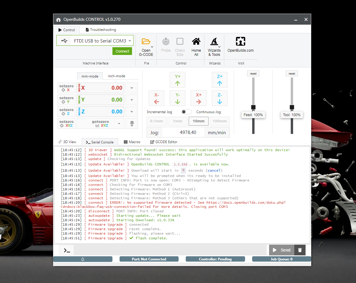

    Went to the workshop today, started the machine - no problems at all, HOME procedure went well as usual, I did set the work position of X axis and started to set the Y axis, when the USB connection disconnected, I tried to reconnect but got the error message:
    [12:32:52] [ connect ] PORT INFO: Port is now open: COM3 - Attempting to detect Firmware
    [12:32:52] [ connect ] Checking for firmware on COM3
    [12:32:52] [ connect ] Detecting Firmware: Method 1 (Autoreset)
    [12:32:52] [ connect ] Detecting Firmware: Method 2 (Ctrl+X)
    [12:32:53] [ connect ] Detecting Firmware: Method 3 (others that are not supported)
    [12:32:56] [ connect ] ERROR!: No supported firmware detected - See docs:blackbox:faq-usb-connection-failed [OpenBuilds Documentation] for more details. Closing port COM3
    [12:32:56] [ disconnect ] PORT INFO: Port closed
    Tried to reconnect once again but no luck:
    [12:33:01] [ usb ports ] Detected a change in available ports: [ No devices connected ]
    [12:33:09] [ usb ports ] Detected a change in available ports: [COM3]
    [12:33:12] [ connect ] PORT INFO: Port is now open: COM3 - Attempting to detect Firmware
    [12:33:12] [ connect ] Checking for firmware on COM3
    [12:33:12] [ connect ] Detecting Firmware: Method 1 (Autoreset)
    [12:33:13] [ connect ] Detecting Firmware: Method 2 (Ctrl+X)
    [12:33:13] [ connect ] Detecting Firmware: Method 3 (others that are not supported)
    [12:33:16] [ connect ] ERROR!: No supported firmware detected - See docs:blackbox:faq-usb-connection-failed [OpenBuilds Documentation] for more details. Closing port COM3
    [12:33:16] [ disconnect ] PORT INFO: Port closed
    As I saw the issue with firmware, where I was sure the USB port is fine, I proceeded to the Wizard option to flash the firmware. but again no luck...
    [12:34:20] [ Firmware Upgrade ] connected
    [12:34:21] [ Firmware Upgrade ] reset complete.
    [12:34:21] [ Firmware Upgrade ] flashing, please wait...
    [12:34:22] [ Firmware Upgrade ] FLASH FAILED!
    Is there anything I can do, or did it die....

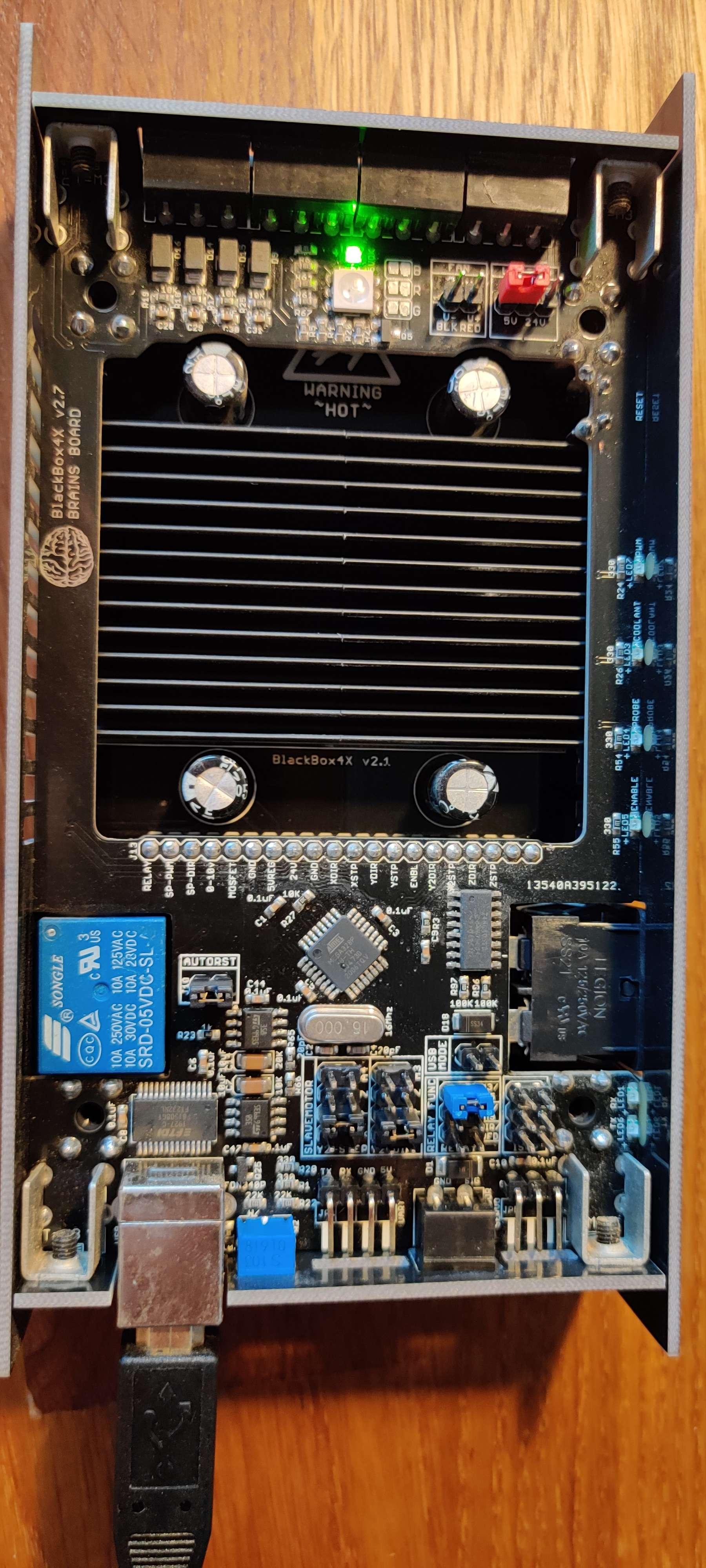

    The LED light is going green, and the USB LEDs on the side just "blink" for a second when connecting the board

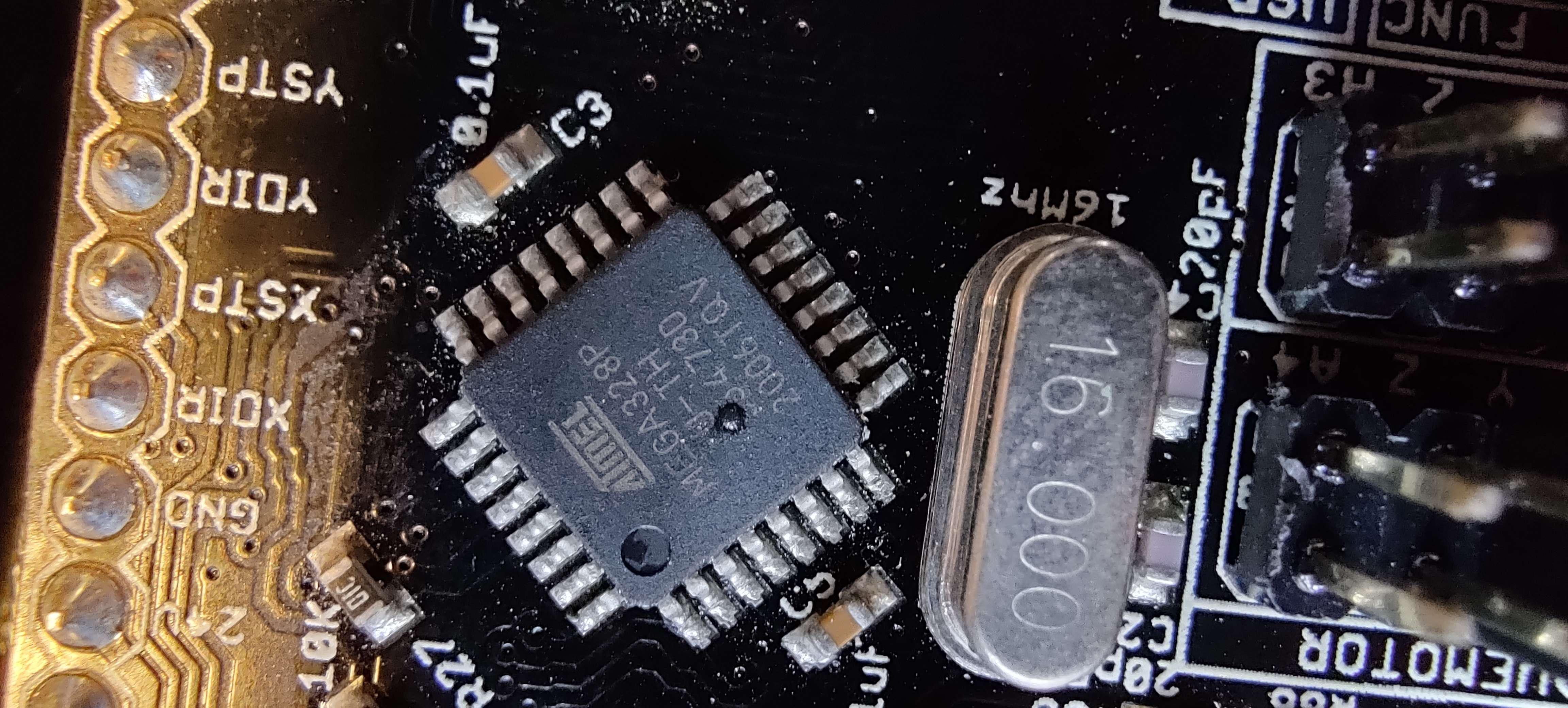

    Closer look at the board got me looking at this microchip, that look strange:
    13,754
    4,070
    Correct, bubbled up epoxy shows signs of a serious short /over voltage condition. See the last paragraph of the linked page above

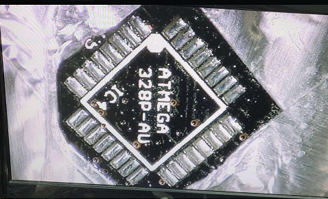

    Small update on my case - I've managed to flash it! afterde-soldering the damaged microchip, and replacing it with a new one - I'll keep you posted if everything works fine tomorrow - but so far so good! the control board looks to be revived at least on this end.

    1. Identify the issue - of course the first step as you can see in my first steps in this topic, was to find the issue - in this particular case is was the problem with the microprocessor - which basically blew up after a shortage of some kind - can't be exactly sure what caused this. Most likely the Y Limit switch, but can't be sure 100%
    2. Check your options - I was out of warranty period, so I knew I'll try to repair - but if you're within the warranty it's probably easier and cheaper to contact the seller.
    3. Repair! So what did I do was going the repair route - Identified the chip which I have to buy - Atmega ATMEGA328P-AU - found it locally for about 5 EUR. What I also did was contacting the Openbuilds support for some assistance, after a few emails exchanged, I started the process, first by desoldering the old chip:
      Be careful on this step - I didnt't have the equipement for soldering SMD elements, and I asked a friend for help in exchange for some good beers ;) but this can be definetly done in any laptop/electronics repair shops for a small fee, if you don't have the equipement.
    4. We also checked for any other elements that could have signs of failure, but we didn't find any. Openbuilds team suggested to check XL1509-5 regulators from the Muscle board, but those were fine, luckily!
    5. Bootloader! After replacing the microchip - it would fail to flash the firmaware - as brand new chips are totally clean on their memory. I went with Arduino UNO method - to use it as an ISP... and I failed. Followed the steps that can be found in Arduinos documentation (https://docs.arduino.cc/built-in-examples/arduino-isp/ArduinoISP) and tbh I couldnt make it work. But after few more tries I made it work - so I'm sharing here how it became possible.

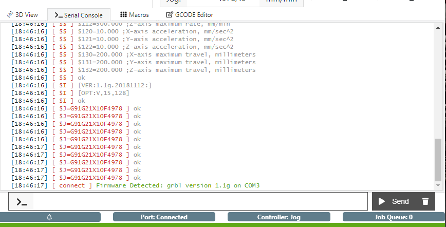

    6. Flash firmware - after sucessfuly burning the bootloader - it'll be possible to flash the firmare via Openbuilds Controls. Connect the Blackbox to the computer via USB-B port, and open Openbuilds controls. You may notice some erros in connection in the dialog box - but that is expected as the software won't be able to recognize the controler yet! Proceed to the Wizard & Tools menu and select Flashing tool, select the appropriate options for the controller and select the appropriate port in the menu, and click the magic Flash button, if everything is correct the flash will happen!
