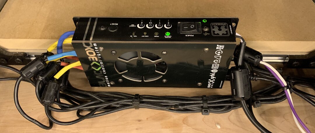

  13. Paul Stoller
    Paul Stoller Journeyman
    Feb 28, 2016
    157
    107
    Added a "spy cam" to the dust show in order to see how things are cutting as well.
    #13 Paul Stoller, Aug 1, 2020
    Giarc likes this.

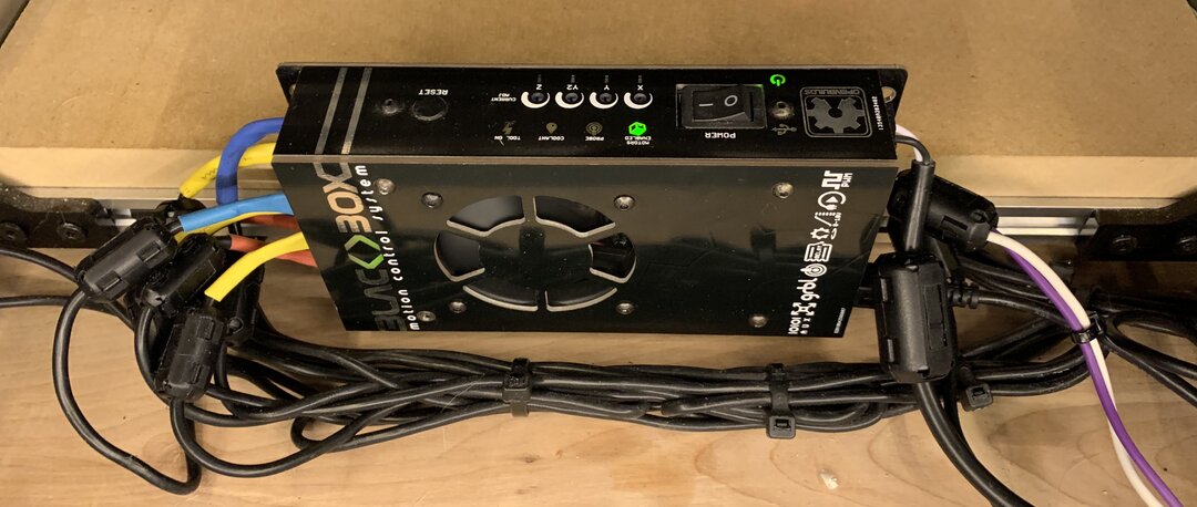

  14. Paul Stoller
    Feb 28, 2016
    157
    107
    On the EMI question, I’m still not certain if it will be a problem but as a precaution I’ve added ferites to all of the connections to the blackbox
  15. Peter Van Der Walt
    14,001
    4,112
    They never hurt :)
    Paul Stoller likes this.
