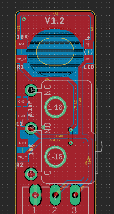

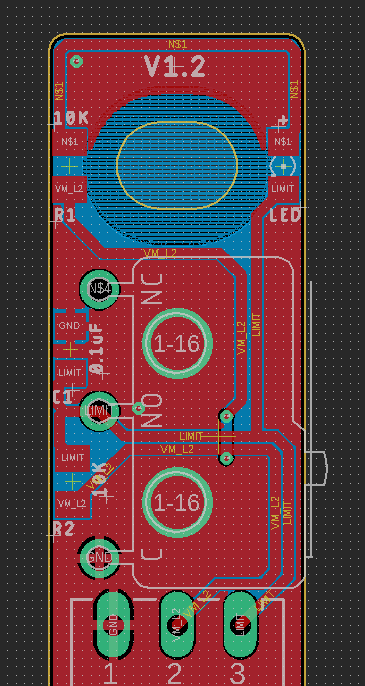

  21. yufasa
    yufasa New
    Dec 14, 2022
    This thread saved me a lot of time - fitted a new spindle replacing my old worn out Makita router and ran into this issue. Apparently the old router was not earthed and I never checked....
    Turns out my external Dell screen has the same problem where the HDMI input is connected to earth on the monitor. What a weird thing but I used a standalone portable screen and confirmed the problem so now I am looking for a new monitor but at least my spindle and xyz touch work like a charm!
  22. JSuster
    JSuster New
    Jun 11, 2020
    31
    Recently ran into this issue after upgrading my workbee to linear rails. The spindle is now earthed to the whole machine frame since there are no longer plastic wheels isolating it. Along with this, the way in which I have the OB limit switches, the head of the screw was contacting the to the board with the electronics. The metal ring is 24V ground and was essentially connecting everything through the frame. Might I suggest additional plastic washers be included with the limit switches to allow full isolation of the limit switch, or, eliminate the ability for the hardware to contact the ground (unless this is intentional).
  23. Peter Van Der Walt
    14,000
    4,112
    How old are your switches? Your suggestion has been implemented a while back
  24. David the swarfer
    3,277
    1,835
  25. Peter Van Der Walt
    14,000
    4,112
    Its wasn't a plated hole, so you don't need the shoulder - screw side has always been isolated, but the bottom pour was exposed. Pulled that back in the 2nd revision. Was only issue if switch was mounted upside down (which sadly some of our build videos do). The intended design has the rubber pad on that side to space the switch pins away anyway, and when mounted right way round the screw head sits on the unconnected cover plate
  26. JSuster
    JSuster New
    Jun 11, 2020
    31
    My switches were purchased in 2020, so if it has been resolved, awesome! I fixed mine with some additional plastic washers and then verified with a meter that it wasn't grounded through the machine chassis.
  27. Peter Van Der Walt
    14,000
    4,112
    Yeah, that was fixed since in the V1.2 switches
  28. JSuster
    JSuster New
    Jun 11, 2020
    31
    I ordered a new switch to have as a back-up (received 10July2023) and I checked continuity between the area around the screw and the ground pin. There is still continuity between the areas shown in the picture. Is this still an old revision? I didn't see any version markings on the boards. If installed backwards (needed in some applications) without a plastic washer, this will connect DC ground to the machine chassis.
  29. Peter Van Der Walt
    14,000
    4,112
    It should be there: (Next to the hole on the main board) - if not its an old rev. Big warehouse, old and new stock tends to float around.
  30. JSuster
    JSuster New
    Jun 11, 2020
    31
    No version markings on mine so I must have received the old version. Just wanted to verify what was discussed earlier because it wasn't in line with what I saw, but it all makes sense now! Thanks for your quick replies.
