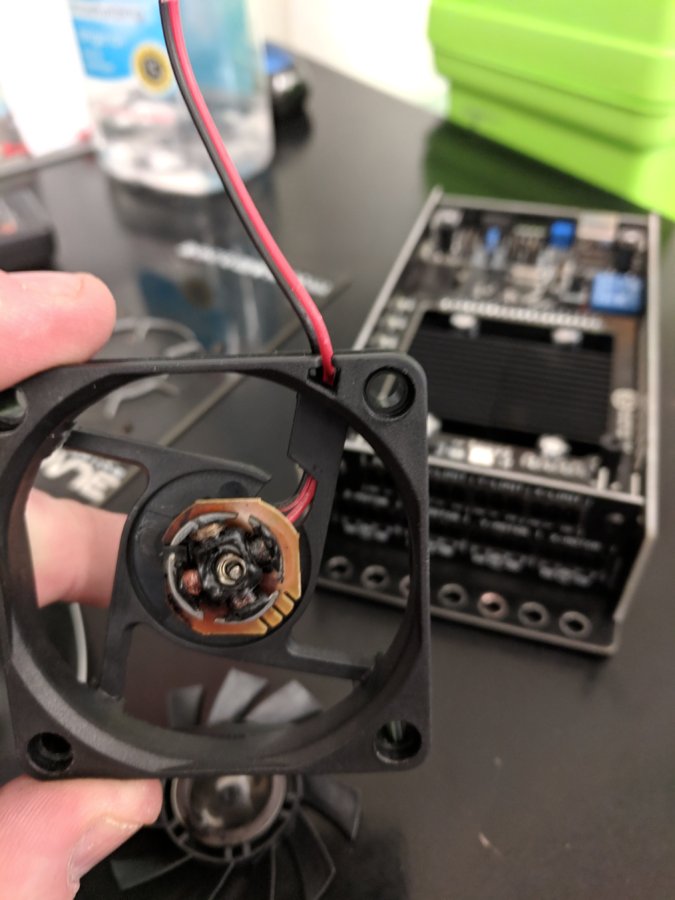

  8. Tim Callinan
    Aug 31, 2015
    Hi All,
    Hope you are all keeping well. Yeah we have a black box here - we powered it up and the fan started smoking. Has anyone else had this trouble? Should i order another fan and test it again?
  9. Rick 2.0
    2,859
    1,526
    Please contact the part store for assistance as this should be a covered issue. You can use either the Contact Us page, email at http://support.openbuilds.com/support/home, or use the messaging function in your OBPS account.
    BTW, how many volts is your power supply?
  10. Peter Van Der Walt
    13,990
    4,107
    @Rick 2.0 is correct, reach out to the store and they'll help you out :)
    Just an extra note, 100% sure you had the fan plugged in with correct polarity? (Have seen before where incorrect polarity caused this to happen)
