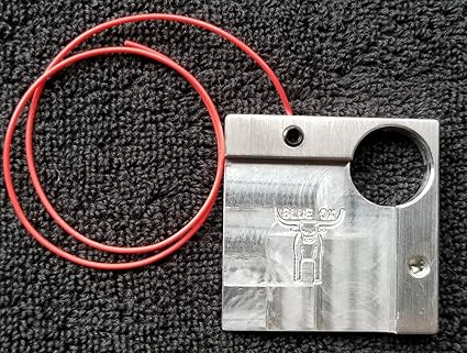

    I use mach3 with 2010 screen set on my other machine and that has all the print scripts built in.
    I've got a touch plate with a hole in the corner. I use the hole to find the center of the corner
  6. sharmstr
    2,039
    1,434
    So, you're actually trying to find a corner. I'm assuming your plate looks like this
    Instead of probing the hole, probe the outside edges. Here's the a post about how to build your code and add it to OB Control as a macro: OpenBuilds CONTROL Software

    Y
    that's similar to what I have made. I can use outside edge probing. The center probing was also handy for other applications.

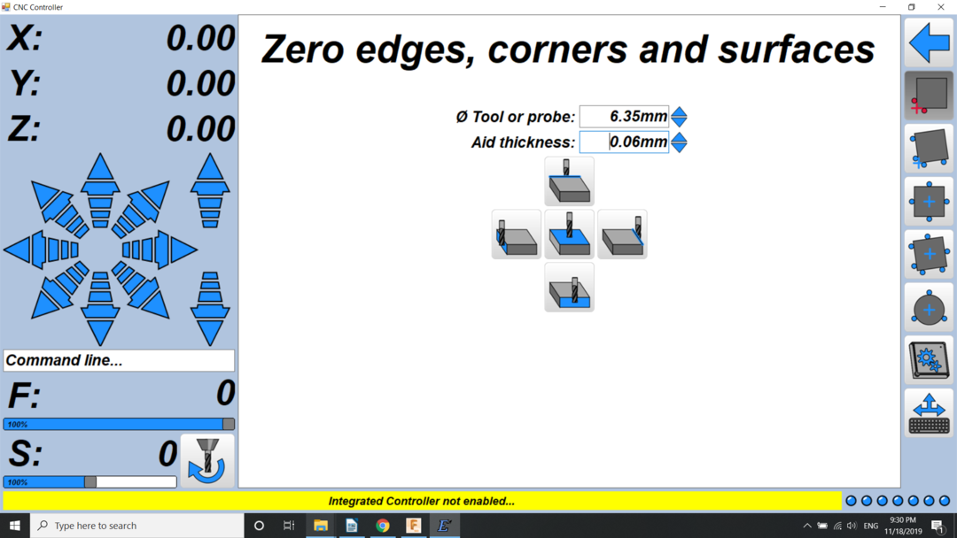

    If you want a whole lot of probing options already built into the software, Estlcam as a free version. I paid for mine ($59) because I really like it and I want him to keep on developing it. I love the center finding and surface scanning functions. There is even a setting where it will raise over your clamps while cutting.
    Center finding at 3:23. I use aluminum tape as well. It works great:
    Automated edge finding:
    Surface scanning.
    Here is a screen shot of the controller software. On the far right are all your choices of probing/centering.

    Awesome. Ill check this out looks like it has more functionality in terms of probing thant he open builds software. Happy to pay too if it does what i need. Im assuming ti will work with the black box controller since its just grbl?
