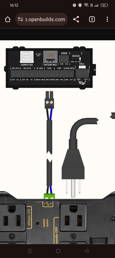

    What connection do I need for the iot relay. Tool, pwm, 0-10v??

    If I wanted to add a second IOT relay where would I connect it? The coolant spot is used up the spindle light.
    14,701
    4,249
    The question might be, what does the second relay need to do? If its for coolant or dust, the coolant output still makes most sense.Can run both LED and Relay off Coolant. Or move LED to PSU (always on)
  7. Adam Jelinek
    Jan 24, 2023
    46
    The second relay would be for a vac system
  8. Peter Van Der Walt
    14,701
    4,249
    Then Coolant makes the most sense to me.
