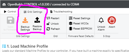

  9. krazeekirk
    Feb 2, 2021
    19
    Hi,
    I am upgrading my Xcarve controller to Open Builds Blackbox and Interface system. I would like to know if someone can guide me on importing the old GRBL settings from my old controller to the Blackbox so I can get up an running. Fairly new to this, but willing to learn with the right instructions. Any and all help is appreciated, thank you for your time.
  10. Jason Moore
    Sep 6, 2017
    31
    17
    Do you have acess to the original config.h
    If not Id hit $$ on control panel with original controller. Take a pic. Then $$ again with black box connected and adjust as needed.
    krazeekirk likes this.

  13. David the swarfer
    3,286
    1,837
    if you run OBControl with the old controller connected and do a settings backup, disconnect that, connect the BB, and restore the backup, should be easiest.
    after the restore, make sure $4=1 otherwise the BB will not enable the drivers.
