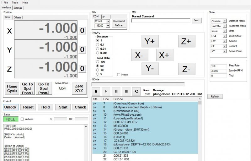

    Hi there.
    I have a work offset question.
    I'm used to using industrial Fanuc and HAAS machines where it is relatively easy to set your work offsets. You basically jog to any location,. hit your position button, grab the the machine coordinate value, plug it into the offset table and bam, you're done. This procedure is exactly the same for for any location you wish to reference.
    I know how to home my machine.
    I can set up G54
    I can turn it off again and find my G54 again...
    I know how to type G90G54G0X0.0Y0.0
    How do I set up and store Any other random offset location?? not talking about a G10L2P2 shift that I cant get to work. Maybe I read the tutorial wrong
    Is it possible to job to any random location on this machine and store it as any location offset?
    Also are there plans in the future to enable tool diameter offsets?

    Try using L20 rather than L2 - sets the current position as zero for the wcs selected by the P parameter.

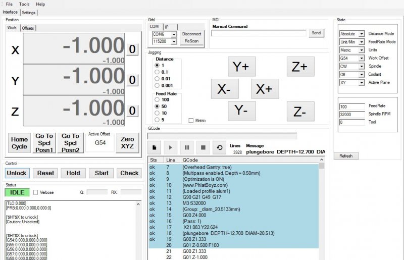

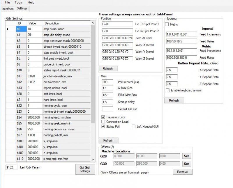

    What Software is that you are using in the picture? I see that you have options for multiple work offsets? I need that!!!

    Ok, I did try that. Here is what it does when I do. ... So I jog to a location. I use the buttons to zero the controller as X0.0 Y0.0. This sets my G54..
    I then jog in Y where ever. Then type G10 L20 P1, ( which is G55 I think) I thought this command set the parameter for the new location as G55.
    My positional display now reads X0.0 Y0.0 ok something happened here. It reset my numbers . Great. I have played with a few commands that alter the work coordinate location, but they always just update the main work coordinate.
    So I then type G90 G0 G54 X0.0 Y0.0 and ....nothing. The machine thinks it is where it is supposed to be.
    Here is another one,
    at work I have used G92 occasionally. The way it is supposed to work is that you jog to a location Set your G54 , after that, type G92G0X10, Y5.0 and it will go an incremental distance from where you just were. The open builds controller just resets the numbers for X and Y in the controller to what you just typed in hence g92 G0 X10.0 Y 5.0 and does not move. Some help here please

    P1 is G54
    G91 is incremental, not G92. If I recall correctly G92 sets a temporary home position - in the Machine co-ordinates system.
    If you want to move while in G54 just type G90 G0 Xn Yn (where n is the absolute position relative to G54 X0,Y0 or G91 G0 Xn Yn where n is the distance you wish to move) Remember G90 and G91 are modal, so once used they remain in force until you change them. Personally I only use relative mode movements for things like probing macros and I try to be rigorous about setting absolute mode at the beginning of job files and at the end of macros.

    Thanks for the response. Can you tell me how to set a G55?

    G10 L20 P2 will set the current location as G55 wcs zero. You might need to add X0 Y0 Z0 to the end of that - I'm not sure if grbl actually requires that or not.

    what GUI software are you using?
    If it is Candle, ditch it, it does not handle multiple coordinate systems and has not been updated in years.
    I like bCNC, buttons for the offsets, no code required (install under Python2.7, Python3 support still a bit buggy).
    OBControl handles it all properly (but has no buttons 'yet').
    Issue G54 (the default) and jog to somewhere, then 'setZero' button and you get offsets
    [09:35:37] [ $# ] [G54:-234.000,-345.000,-22.000]
    issue G55, jog somewhere, use setZero button and you get G55 offsets too ($# to see offsets in serial console)
    [09:35:37] [ $# ] [G55:123.000,321.000,-3.140]
    [09:35:37] [ $# ] [G56:0.000,0.000,0.000]
    [09:35:37] [ $# ] [G57:0.000,0.000,0.000]
    [09:35:37] [ $# ] [G58:0.000,0.000,0.000]
    [09:35:37] [ $# ] [G59:0.000,0.000,0.000]
    To see the offsets a different way, issue
    G53 G0 X0 Y0 Z-10 ; -10 to avoid hitting home switch
    then issue G54 or G55 will show the offsets in the main display as 'current position', just keep that Z-10 in mind.
    With standard homing to positive ends of travel offsets will normally be negative.
    GRBL is the firmware in the controller, and it follows what LinuxCNC does with G92
    Home · gnea/grbl Wiki (read all of this, knowledge is power)
    G Codes
    I learnt very quickly to avoid G92 since it affects ALL coordinate systems, a disaster when you want to move G55 a little but leave G54 alone. Instead I do jog moves or relative moves like G91 G0 X0.345 and then setZero for X (actually normally do this in Z to cut a little deeper, but you get the idea). Don't forget to G90 to go back to absolute mode.
    Keep in mind that GRBL just does the basics and all the bells and whistles are up the GUI you choose, and some are better than others, and some are just way out of date. OBControl, bCNC and UGS are the most popular for good reason.

    Thanks for your help with that. I believe it was the way I was using the controller. before didn't have a good grasp with the Serial Console and how it functioned. I have them all working now!! Even did a power shutdown verification.
