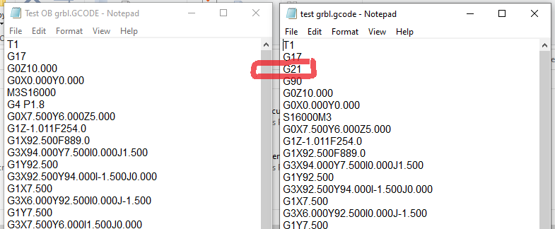

    Those are both mm. Does the inch version add the G20?
    The units and motion mode should always be included.
    #1111 Ferreri, Jun 9, 2020

    No.

    It's in the post processors supplied by Vectric - comes up in my list of post processors if you scroll down far enough. Let me know if A) you haven't got it, B) want it and I'll pm it to you.

    A) Nope...not there.
    B) Sure...I'm curious.
    Regardless, the
    "G20"
    "G90"
    should be added to the header.
    Alex Chambers likes this.

    Agreed. I'll pm the two Openbuilds post processors to you.

    We tested both in the Lab here, and we cannot replicate your issue (it starts running for us)
    If you still have the issue, please provide the files. Thanks

    Attached updated Posts as being sent to Vectric to include in a future update, but you guys can go ahead and install them already so you have the fixes for the missing G20/G21 and G90s
