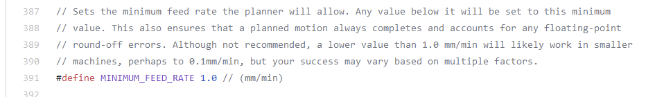

  15. David the swarfer
    3,331
    1,867
    what is your feedrate? GRBL has a minimum feedrate of about 50mm/minute.

  16. Rob Taylor
    Rob Taylor Master
    Dec 15, 2013
    1,470
    746
    A low acceleration rate shouldn't disproportionately affect a low-speed move because it comes to full speed much earlier in the move.
    Minimum pulse rate is quite low, assuming ~20 steps/mm or so, that's just a few steps a minute.
    However, I'm slightly confused about the table. 0.4 degrees is about 0.2 steps. So what exactly is the mechanical setup of the gimbal? It's hard to diagnose pure numbers.
