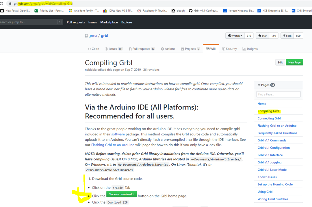

    Grbl 0.9 is quite old! Last version was in 2015, so most hosts applications these days will not work with it.
    Grbl 1.1 has been out for over 3 years now (Dec 2016) (and even that has been surpassed by newer versions too with 1.1h out since Aug last year) see gnea/grbl and gnea/grbl
  4. Steve77777
    Feb 7, 2020
    Thanks can I download it for free please, and how
  5. Peter Van Der Walt
    13,749
    4,070
    Refer to:

  7. Steve77777
    Feb 7, 2020
    Thanks for reply, opened up page, could not see any download options though, is there a way of downloading 1.1,
  8. Peter Van Der Walt
    13,749
    4,070
    Refer to the wiki it has detailed instructions (do read it all of it, its worth the read and worth the time - its all there!
  9. Steve77777
    Feb 7, 2020
    Ok thanks I will look now

  11. Peter Van Der Walt
    13,749
    4,070
    Are you still on Grbl 0.9? If yes, update first. Read the wiki, it really has all the instructions
    Or consider an off the shelf solution like docs.openbuilds.com/blackbox if you need an "easier" and more modern solution
