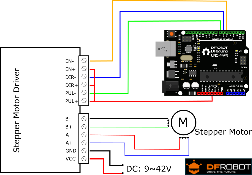

    Hi, I'm building my first CNC and been running an Arduino Uno with GRBL and UGS. After the last test (which went fine) I can't make the machine move in negative direction on any axis. I've been reading documentation and doing some research but can't fix it.
    Nothing changed between the last test and now, the electronics are untouched. Can anyone point me in the right direction please? Very much appreaciated. Thank you

    Maguru, check your "DIR" signal wiring.
    Gary
  7. maguru
    maguru New
    Jan 30, 2020
    I will, but I don't think it's that because it was working fine during the last test and I didn't re-wire anything. Also, it's all the motors that don't work on the negative direction. I see the position changing on UGS but nothing happens on the hardware.

    Well, FWIW, flaky wiring is always fine until it's not. Check your ground wires, too.

    So lemme get this straight:
    You can jog any axis (X,Y,Z ) with the + jog button, and it moves. Use the - jog button on any axis and it does not move. Correct?
    It was working properly, you didn't change ANYTHING, and now it's not working...
    This is very strange. It's almost like your direction pins are not changing. Or the motors are not getting enabled in one direction.
    What type of stepper drivers are you using?
    MG

    That is correct, I can't jog in negative direction, and when I send a Gcode File it only moves in positive direction, the negatives are ignored. Same goes for Returning to Zero. It was working fine, I made several tests a day prior to this malfunction happening. I am using 3 Nema 23's for X and Y, and a Nema 17 for Z, the drivers are all TB6600 and the board is an Arduino Uno. I will do as
    phil from seattle said and double check the connections, he mentioned the ground and now I'm suspicious because I focused mostly on DIR and Pulse wiring. Hopefully it's that...

    If you are using optoisolated stepper drivers (TB6600 drivers usually are) there is usually no ground connection required. Depending on how you wired them up, of course. Normally, all the opto +'s are wired together to 5v, and all the -'s go to the signal pins on the Arduino. This is for active low signal polarity. For active high signal polarity, they are wired opposite, all -'s go to ground and all +'s go to arduino outputs. Check the enable lines, and the 5V line.
    Just thought of something, check your $130, $131, and $132, they should be set correctly, and Soft Limits should be disabled.

    Actually, you can wire the opto inputs in 2 ways, sig/gnd or +5/sig. It works either way - think of +5 as + and gnd as -.

    I'm really a newbie so I really appreaciate you taking the time to reply. The wiring I made is different to that. I'd have to double check but I'm not at the shop now. I daisy chained all the negatives to the ground. Can't remember the Arduino pins. But something like this.
  17. maguru
    maguru New
    Jan 30, 2020
    Then I will rewire everything and make it this way. Thanks

    You can use either method, it makes no difference. Other than one method requires you to invert the $2 and $4 parameters in GRBL settings.

  21. maguru
    maguru New
    Jan 30, 2020
    I checked and all connections were solid. So I changed to another ground pin on the Arduino and now it works. It didn't even crossed my mind. No idea if the pin is fried or what, but it works!
    Thank you both and sorry to be a nuisance. This was the first time on the build that I've felt clueless as to what to do.
