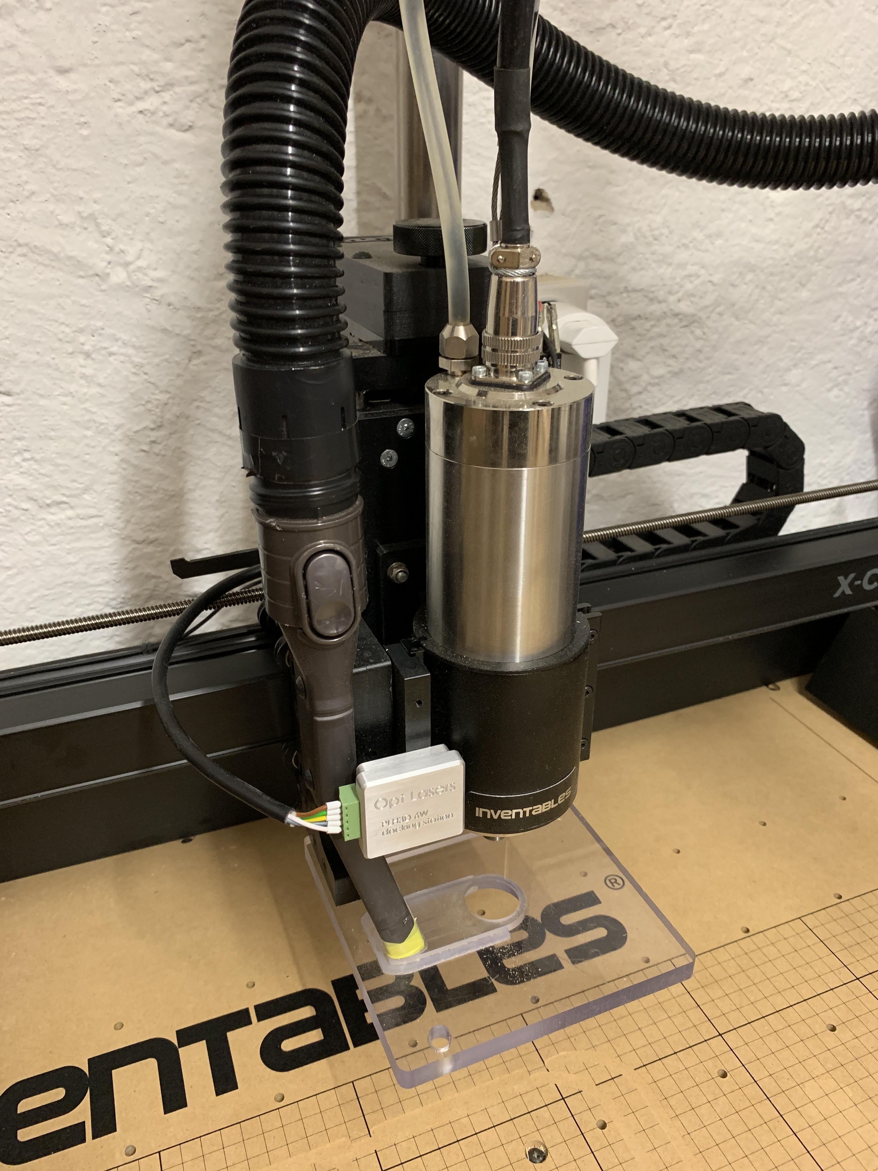

  4. Giarc
    2,915
    1,619
    However, some of the pins have changed on newer versions of GRBL compared to when the CNC shield V3.0 was designed. gnea/grbl
  5. jbarrero
    jbarrero New
