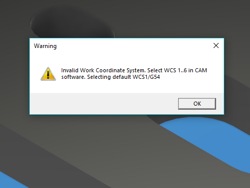

    The problem is in your Machine Coordinate System (also known as home) and your G28 settings.
    The controller uses several offset coordinate systems but they are all relative to machine coordinates.
    (Machine Position in UGS)
    The industry standard for machine co-ordinates is X at the positive end, Y at the positive end, and Z at the positive end (all the way UP away from the work, a safe place!).
    When GRBL turns on it sets the machine cordinates to 0,0,0, this means that you have to physically position the machine before turning on.
    G28 normally defaults to 0,0,0 which means that it is the same as the machine co-ordinates.
    A G28.1 command will set the offsets to wherever the machine is at the time. Thus machine 0,0,0 can be anywhere IF you are willing to always move the machine to a safe place (Z high!) and issue G28.1
    When you set your workpeice coordinates you are changing one of the 6 Work Coordinate Systems, selected by G54 to G59. (note that UGS only ever sets G54 offsets, which is why I prefer bCNC vlachoudis/bCNC)
    (Work Position in UGS)
    Basically, Machine Position for Z will always be negative when zeroed to your work.
    The default Fusion360 postprocessor expects that the machine is set up according to industry standards and the machine coordinates and G28 are correctly set.
    You can turn off the initial G28 in the post settings
    OR
    you can use this post
    swarfer/GRBL-Post-Processor
    which does not use G28. It still expects that machine 0,0,0 is set correctly for safe movement at machine Z=0

  26. Prometheus
    Mar 21, 2015
    17
    I have the Panucatt Gradus board and I have built a custom OpenBuilds C-Beam machine and I am having some issues (more like settings,parameters that need tweaked) and wanted to see if anyone could PLEASE help out?
    When I use Fusion 360 and post process (grbl IS selected), I open UGS to load file and prepare to start. I hit play and I keep getting the tool change T1 M6 error and I would like to know what I can do/change so that is NOT in my .nc files anymore. It is ANNOYING to have to open the file and delete it and save and then reload every time... Hope someone can give some advice. I would also like to have a set spot for tool change but have not figured that one out yet.
    TIA!
    Below is the config for Fusion 360 grbl post processing
    Code:

  27. David the swarfer
    3,272
    1,833
    The default GRBL post is not very good. GRBL has never understood tool changes so why is that even in there.
    It also uses G28 and most hobbiests don't understand proper machine setup for that to work reliably....
    Maybe you can try this one that I have been tweaking for GRBL
    If you ever get an error 33 from GRBL then check your leadin/lead out radii, Fusion tends to make them very small which leads to radius errors reported by GRBL.
  28. Prometheus
    Mar 21, 2015
    17
    Funny as I have downloaded that 5 min ago and was messing with it but I am getting an error. I have homing switches setup also and would like to home before and after job if possible. Other than that, it seems good. Not sure what the -10 coords are for in the PP? I home to -X/Y and +Z

    you need to do exactly what it says (-:
    in each setup in Fusion you need to set the WCS that it is using. normally this is G54 or '1' in Fusion terms.
    right click the setup and set the WCS as shown in the video below
