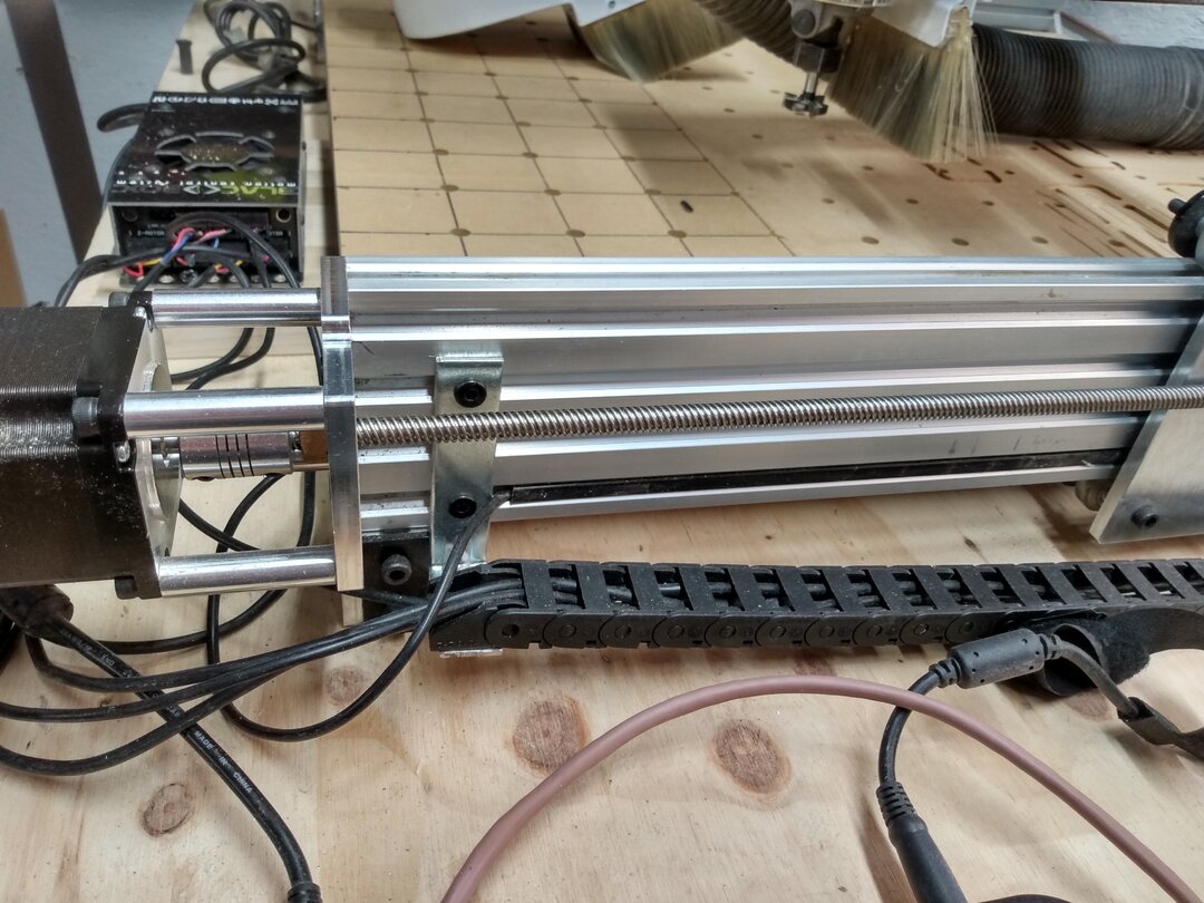

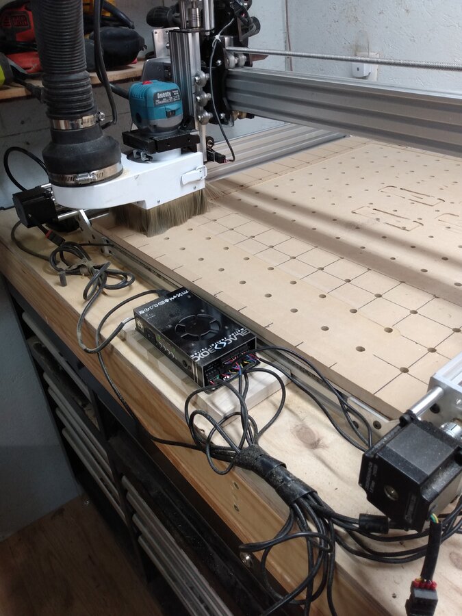

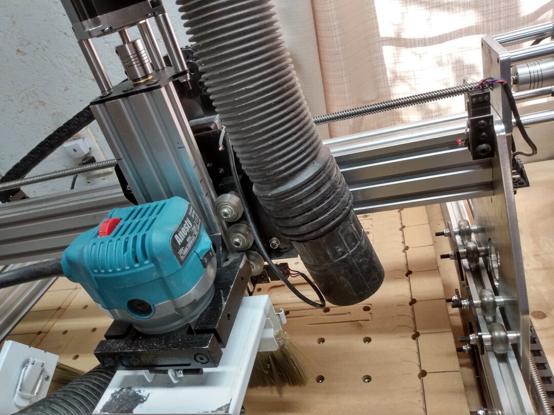

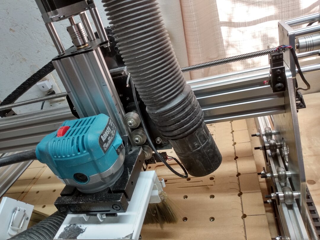

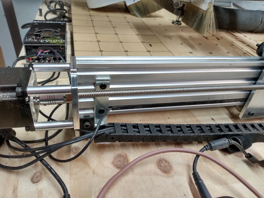

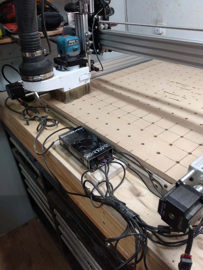

  5. marlin adams
    Jul 15, 2021
    48
    Alright I got my machine upgraded to acme acme screws both Y and X axis. IMG_20230110_145627362_HDR.jpg IMG_20230110_145619369_HDR.jpg IMG_20230110_160723321.jpg
    13,753
    4,070
    Looks good. Just watch out - where you have the BlackBox mounted, it looks like it will be exposed to a lot of cutting dust/chips (even with good extraction, there is always some that get past the dust boot)
