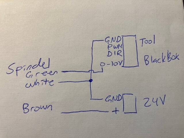

AMB 1400 FME-P DI connected to blackbox motion control does not start
Discussion in 'General Electronics' started by fabien-h, Nov 12, 2022.
  1. fabien-h
    fabien-h New
    Nov 12, 2022
    In the final step of my machine assembly (workbee 1510 from ratrig), I've connected my spindle to my blackbox controler according to this schema :
    With OpenBuilds control, I can move the cnc over its 3 axes, but when I try to start the spindle, the led turns on on the blackbox, but the spindle is not starting.
    Before I send it for repairs, what can I try to troubleshoot ?

    Thank you very much for your answers. The wago connector that connected the 3 wires was faulty... I figured this out using the method Gary linked with a tension meter. There was one before the wago, but not after...
