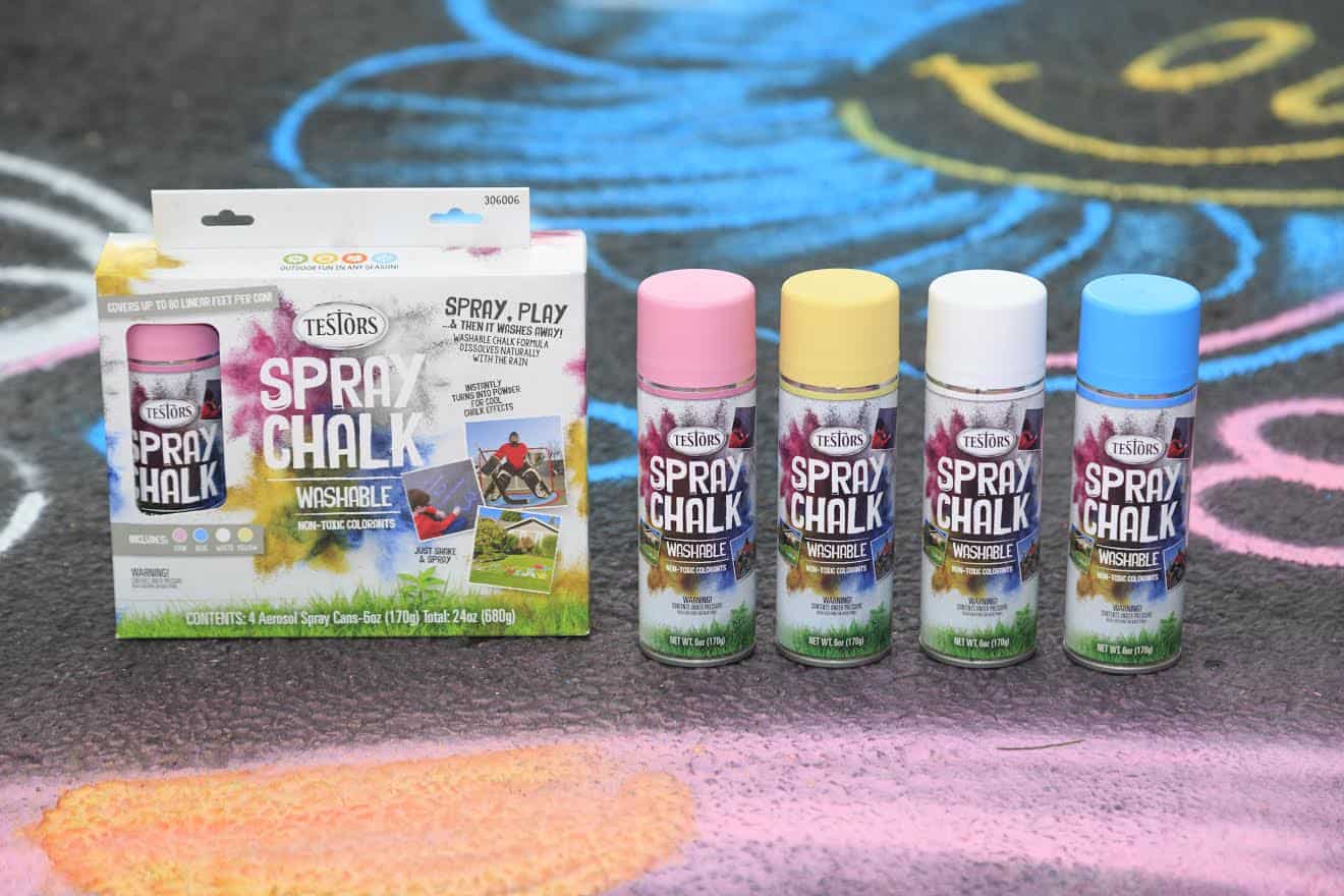

    If the Z axis is solid (ie not spring or gravity dropped) the chalk gets shorter as its used and later can't touch the pavement? (unlike Pens that stay the same length)
    (; or overengineered option - switch to chalk in a can that the servo presses the spray head (;
    No drag, no height compensations, etc
