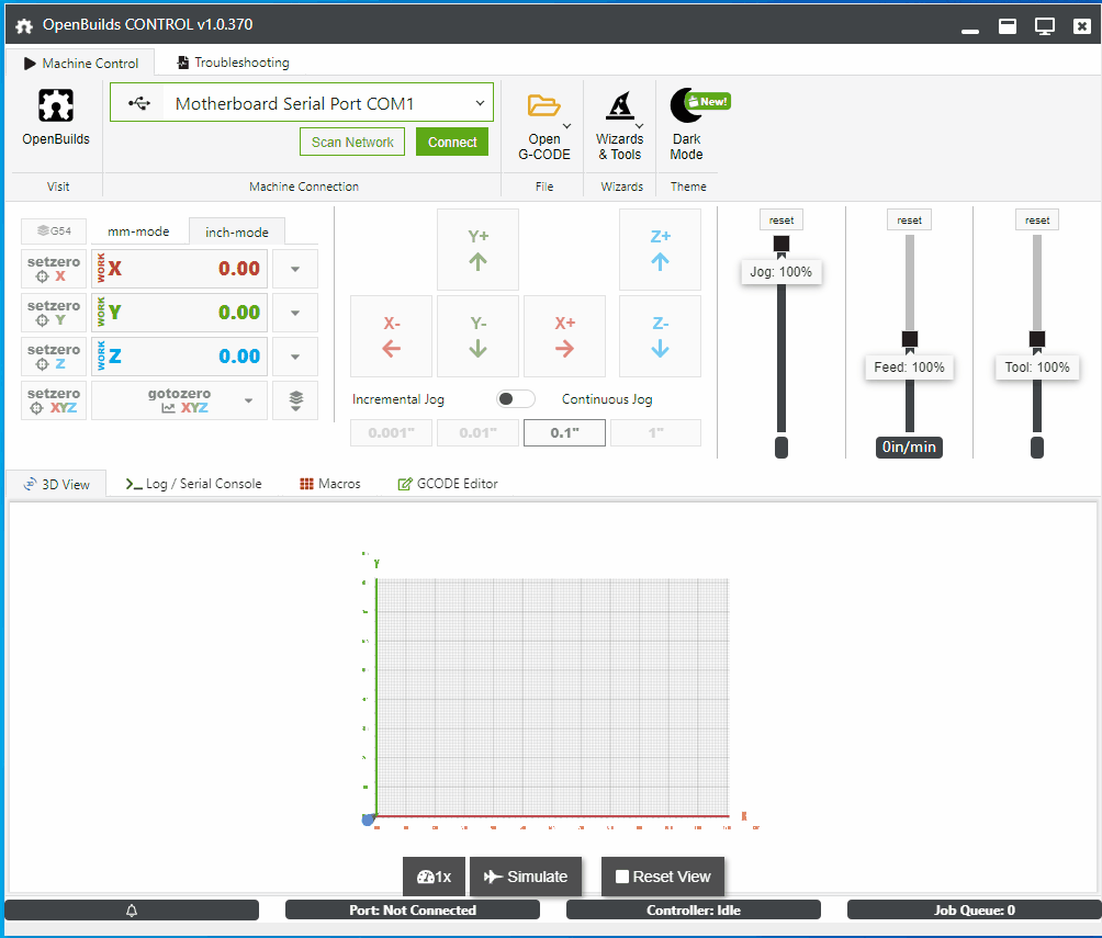

    7B1B3BB5-286F-4D31-80B0-BDADC3D08712.png F172F906-E524-4C68-8D9C-0124151C1AE9.png I’m trying to enable the pen lift on a acro 1515 but the servo options are missing in grbl settings… any advice?

  7. Peter Van Der Walt
    14,701
    4,249
    Profile or Firmware?
    Check your machine using pen up/down buttons, and don't forget the Calibration steps (Wizards and Tools menu). Once calibrated, don't forget to incorporate those values into your CAM workflow. Its rarely 0/255 - most pen mounts don't use full servo travel range

  9. Peter Van Der Walt
    14,701
    4,249
    Try restarting controller and PC
    Are you sure the flash was successful? With the correct firmware on it the buttons should show up on next connect

  11. Peter Van Der Walt
    14,701
    4,249
    But does it show success or fail?
    A full startup log will tell is more than the version number (looking for OPT to contain a Q)

  13. Peter Van Der Walt
    14,701
    4,249
    No Q. Are you sure you selected the Servo option?

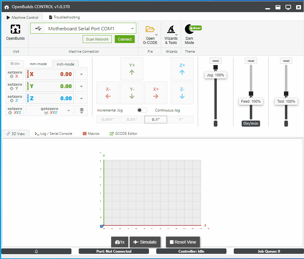

  19. Peter Van Der Walt
    14,701
    4,249
    Works just fine in testing... As it should and always has
    The Servo firmware is still 1.1f, so you haven't flashed it (correctly) yet. As the earlier line of questioning constantly also pointed at.
    [20:08:47] [ $I ] [VER:1.1f.20170302:LEADMACHINE1010]
    [20:08:47] [ $I ] [OPT:QVH,15,128]
    Try flashing with a Windows PC - python on Mac has always been terrible

  24. Peter Van Der Walt
    14,701
    4,249
    It should work, screen recording as above
    You can check it its in the Documentation: docs:blackbox-4x:jumper-autoreset [OpenBuilds Documentation]
