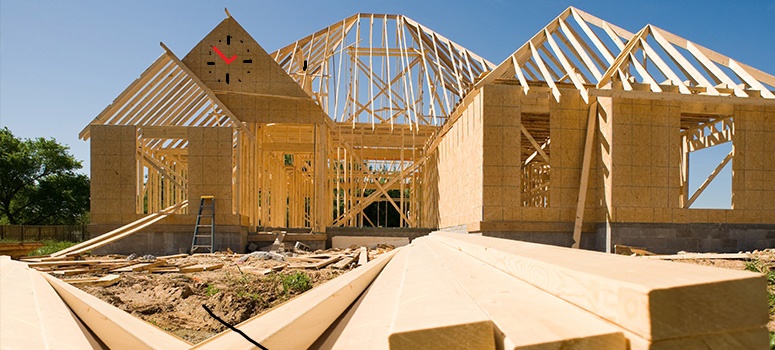

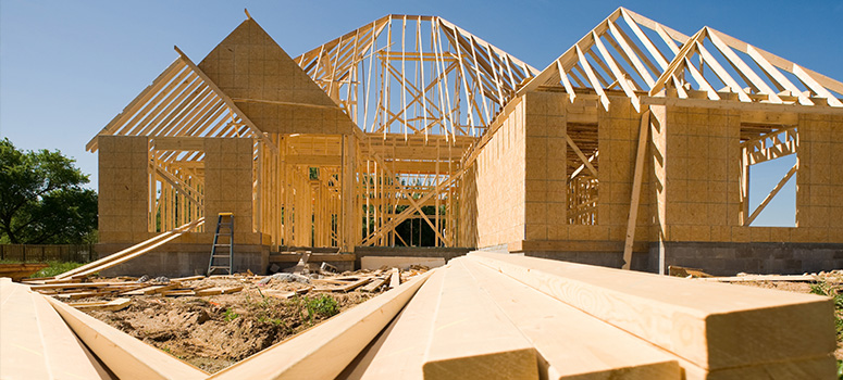

    Does this count? ;)

    Nice looking project! A very ambitious DIY project. hope all goes well. Should be room for a great workshop in there somewhere.

    I wish I was really building that house, I would doble the space I have for my hobbies! (Currently using 800 Sq ft of the house)

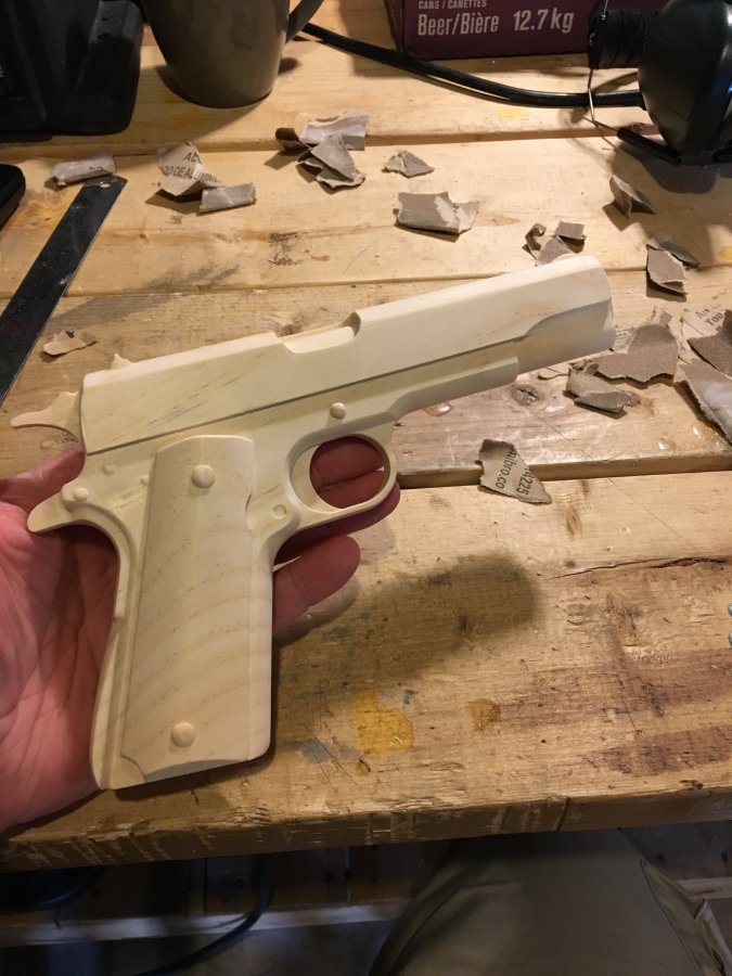

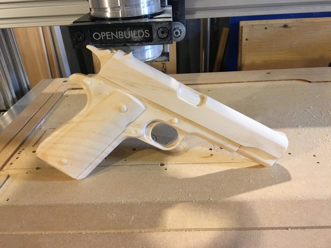

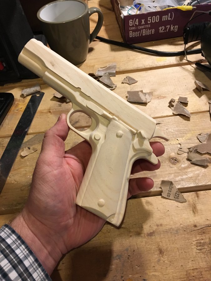

    A Colt m1911a1 (my first double-sided cut).

    Hi Craig,
    This was my first shot at it but it went fairly well. I learned a few things that I will try next time.The trick for me was to have very square stalk (I spent some time with this). I also had milled some of my spoiler board away to give me relative to the machine X and Y positioning "ledges". I had already done this when I was testing my machine's setup. Using a piece of 3/4" MDF as a spacer to accommodate for the rounded spoiler board corner, I fastened it down in the corner with a few screws. With my stalk dimensions in hand, I started working away in Fusion 360. I configured the CAM to "float" the model in the center of the stalk. After milling a series of cuts for one side, I unscrewed the stalk, flipped it over, re-fastened, then changed my origin in Fusion 360 to the inverted corner. I created new toolpaths then began milling again.
    Lessons learned: I haven't built a touch plate yet and my zs were off a little bit after the flip. This was because I had to reset my TinyG after it (or I) messed something up, post flip. Theoretically, I shouldn't have had to so do this but if I had had a touch plate it would have much easier to correct / reset. I am using Fusion 360, Chillipepper and TinyG. I like Chillipepper with the exception that it seems to loose communication intermediately with the TinyG (about once every 3-4 hours but it varies). I'm not sure what is taking place but I suspect the JSON server or Chrome being pushed to it's limits. Chrome and Chillipepper get sluggish and very RAM intensive with large G-code files. I may take a swing at writing a standalone executable in the future. Mach3 doesn't support TinyG...
    Another thing that I would have done differently, is cut my spoiler board to a "sharper" corner for positioning (this would remove the need of the MDF offset).
    Finally, I would have waited for more end-mills to arrive in the mail. :) The smallest that I had on hand was 1/8". 1/16" or even 1mm would have made for some amazing detail. Maybe for round two in maple or walnut...
