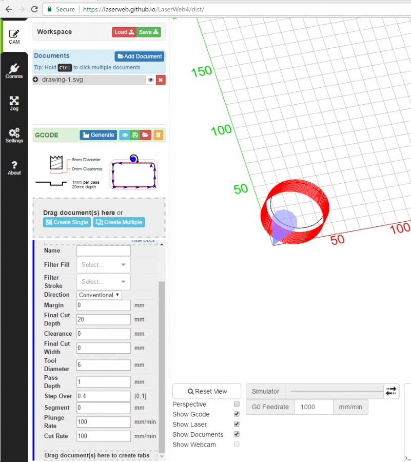

    Since you have a GRBL board take a look at LaserWeb as Peter has suggested or EstlCam. I think you will find either will do most all that you are looking for.
    I have been impressed with EstlCam can do for generating toolpaths (supports Trochoidal/ HSM!) and It also has the ability to interface with Adruino based controllers for direct CNC control. I see that EstlCam now also supports the xPRO V3 board also!

    I use either Sketchucam or Fusion 360 (both free) to design parts. Both have very good video tutorials and are not difficult to learn. Both generate the Gcode needed to cut what it is you want to make. This also applies to Dmap and Fengrave for engraving (also free). The only thing I use an interface such as GRBL Panel to do is zero the machine where I want it, and send the gcode to the CNC router to do the cutting. Here are other interfaces for grbl: Using Grbl · gnea/grbl Wiki · GitHub All of this can be done with your existing Arduino based equipment. I would try the stuff you have first before investing in Mach 3/4. I have Estlcam, but have not played with it much yet.

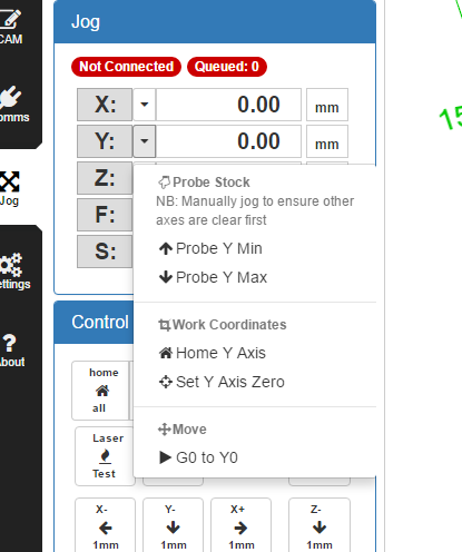

    I'm indeed learning Fusion myself to design parts. Have used Sketchup before, but Fusion looks a lot better. And Fusion has many great tutorials on Youtube. I now really just need some info on how to wire the uno to get autolevel/edge and limit-switches to work. Looks like it's much info about it on the net, so should get that to work. Hopefully.
  15. Peter Van Der Walt
    13,754
    4,070
    Wire one end of the wire to the PROBE pin (A5) and the other to GND
    When it closes (connects together) it triggers as a "probe"
    In LaserWeb there is probe per-axes in the dropdown next to the DRO for each axis
    I clip the PROBE pin to my endmill, and my GND wire to a metal corner piece. After probing, I jog to correct for the endmill diameter (1/4 inch for example = jog x and y +3.175mm (radius of cutter) to center 0,0
