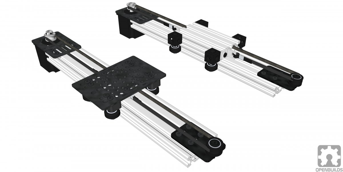

  3. Rick 2.0
    1,323
    528
    Possible, yes. Whether it will be well suited to your needs is another issue. Belts stretch and this may have an impact on usability.

  8. Mark Carew
    1,902
    1,036
    You should be more then fine with this @rtfm and if you need more tension you can add one of these Timing Belt Tension Torsion Spring to the belt to take up any extra slack that may be there.
    Hope this helps

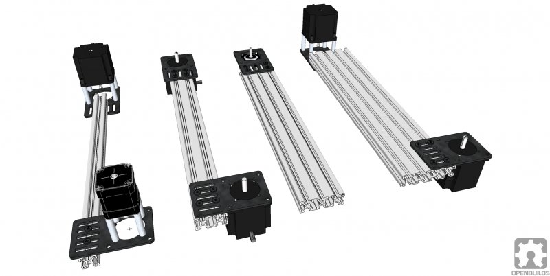

  21. feffe
    feffe New
    Mar 29, 2016
  22. Rick 2.0
    1,323
    528
    I believe that is an error in the drawing. The intent of the drawing is to show the various motor mounting possibilities/systems and it looks like as that was the focus, the belt attachments were not fully (and properly) drawn. The belt at the front would attach just like the one at the center.
