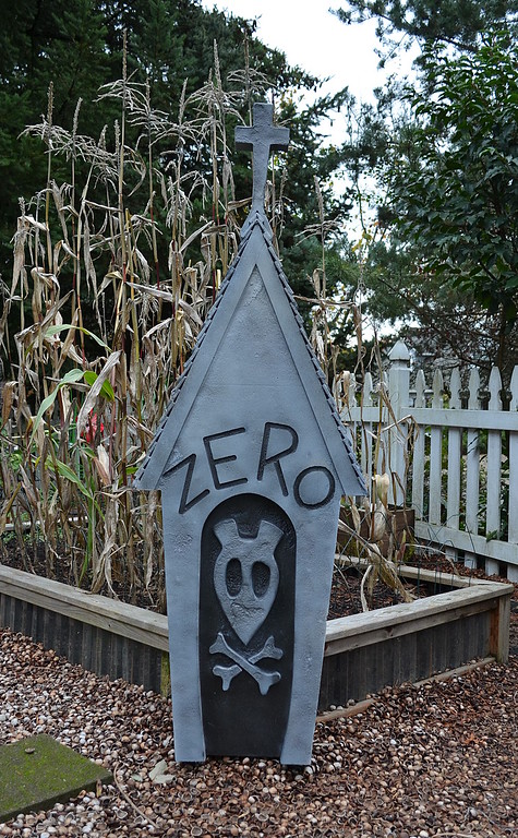

    I use Fengrave (free) for V-carving. I just make a drawing with whichever font I want by putting the picture/logo/whatever in an LibreOffice document then put the text where I want it. The whole thing can be scanned as a bitmap for Fengrave. Then, In Fengrave I just make the overall size what I want it and choose the deepest depth of cut. I used Fengrave to make this 2' x 4 ' carving (lettering, skull and cross bones):

    Giarc. Nice I will check this one out. I would love to see some of your work.

    Thanks. I haven't done a whole lot yet. Just a couple of plaques and that Halloween Tombstone. I am currently learning the process of adding pictures to parts in Fusion 360. I have a great one all ready to go, but for some reason I can't get the CAM to work on the letter E in the design. Every other letter and part of the picture works but that stupid E. :banghead:
