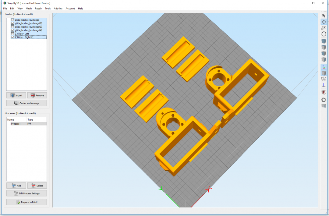

    Going to reprint the glides and inserts. I used the same layout you have in the STL file and it looks like this...
    Is this what you were meaning? Note that these glides are for an ACME lead screw.
  29. Keith Davis
    Keith Davis Veteran
    Dec 11, 2013
    506
    394
    Yeah. The Y axis sets the width of the inserts AND the width of the cavities they set in.
    Since you had to remake the glide bodies for the 20x40, are you certain that you tapered the cavity top-to-bottom the same as the originals?
  30. Elmo Clarity
    Elmo Clarity Journeyman
    Jan 17, 2015
    505
    149
    I used OpenSCAD to cut and paste the original part so there are no changes to the part other than the width in that area.
