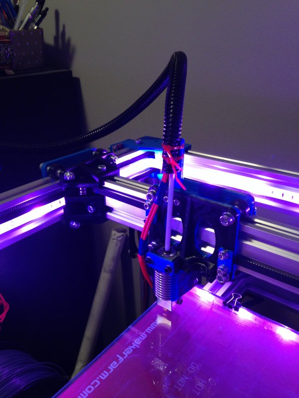

    No worries, I think we are all new to this really. The groove on the back of the slider is for LED clearance. I got some 5050 RGBWW to run all the way around the top of mine. Run it off the HBP PWS.
    This is Carls Bot
